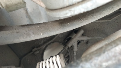

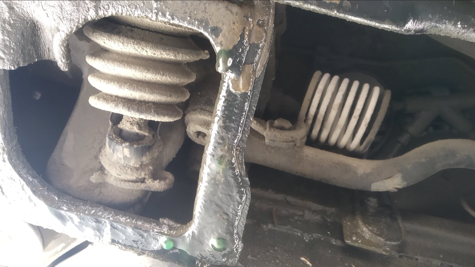

Am surprised it’s been this long! Not been driving the car so battery was flat. Sigh. Anyway finally took a look. There’s a 3 way joiner in plastic where it’s broken off. 1 pipe goes to the front, 1 to the left rear suspension sphere assembly and the 3rd to the centre sphere assembly (I think).
Can I replace the joiner or must I replace the pipes?

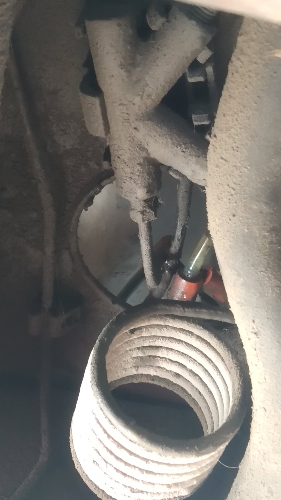

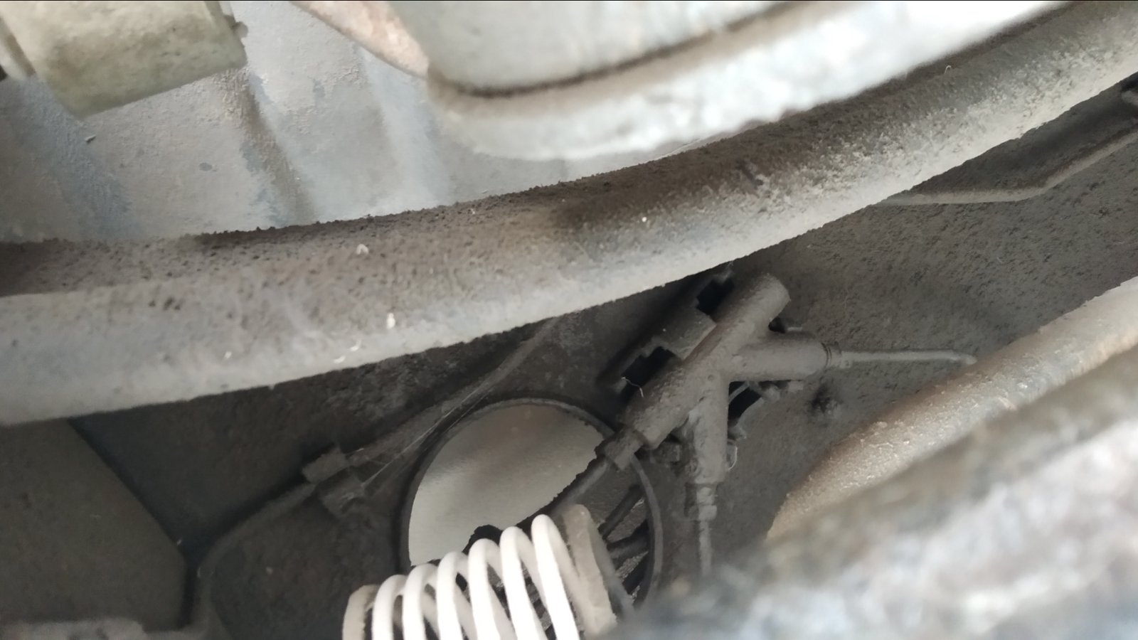

Red bits are the pipe ends.

I presume you're referring to the red t piece? Yep, just change it, there is a similar one at the front. It also looks like the clear plastic return pipe isn't pushed far enough it. They become brittle and split.

That's correct.moizeau wrote: 06 Feb 2021, 15:54 It also looks like the clear plastic return pipe isn't pushed far enough it.
The small bulge in the clear plastic pipes should go a few mm inside the rubber elbows/joints, so it resists pulling out.

Thanks. Will make sure I push the pipes well into the new t piece. The t piece has completely disintegrated so hopes the pipes are ok. It’s very messy, LHM everywhere, so needs a good clean.

The clear nylon pipes more-or-less go on for ever. It's just the rubber joiners that eventually peg out.
