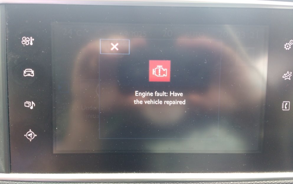

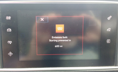

Driving back through France to the UK last week the dashboard, and then the centre display, showed these warnings:

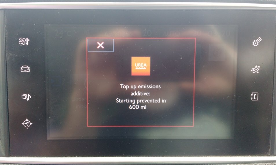

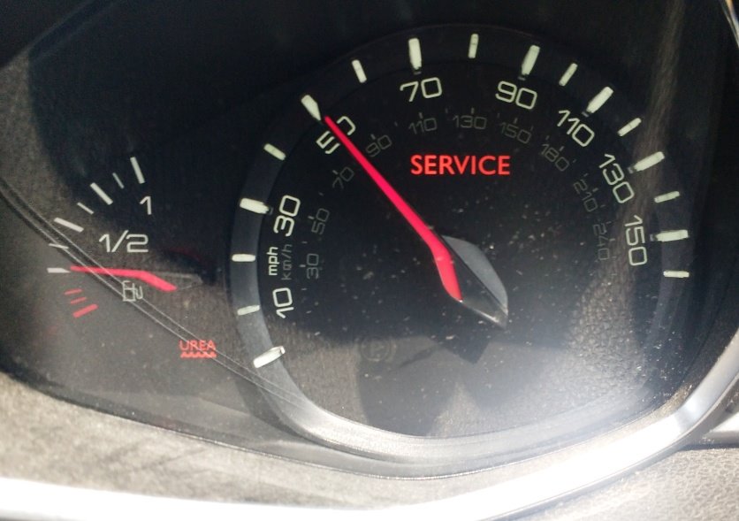

This showed first and then, when the UREA warning light started flashing, these also came up:
At one point this message showed. I had topped the Adblue tank up before we went away and it was still about 2/3 full when we got back: A few times the warnings would stop displaying and I wouldn't notice that until they restarted. This had the fortunate effect of resetting the "Starting prevented in 700 miles" message as I had worried about not being able to make it back home.
Even stranger, the car surprised me by going into Stop & Start mode at the Channel Tunnel check-in booths. There's a long list of things that have to be "just right" for that to happen. S&S then engaged again a few hundred yards from our house while we were waiting at some traffic lights. This after having the warnings displayed for most of the trip up through the UK.

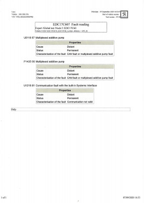

I was able to run the Diagbox a couple of days ago and after clearing the faults and then running the engine these are the faults that came back:
Is this the dreaded Adblue pump failure problem? Or maybe, even though it's not mentioned, the Adblue injector?

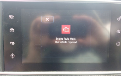

I think that you'll find this is the dreaded UREA pump fault and if I'm not mistaken, well-known inside PSA, with their recommended action to replace the whole UREA pump assembly.
I think you'll need to contact the dealer with this one Paul as I don't have the specifics for this engine, but the combination of the U0118 87 and the P1435 00 would certainly indicate this.

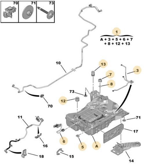

I think this would indicate that the whole thing reservoir and pump comes as one unit as I can't see a separate pump anywhere, but item (1) and constituent parts.Paul-R wrote: 10 Sep 2020, 20:50 What's the part number for the tank and pump please? I'm aware that there is a supersession and that the new one requires an update for (presumably) the engine ECU. This will no doubt be a dealer only job.
Do you have the details of what's involved with removal and fitting?
The latest part number is: 9818559380, priced at £986.44 inc. VAT from Peugeot.....
I don't have the removal / fitting guide for this model, sorry.
