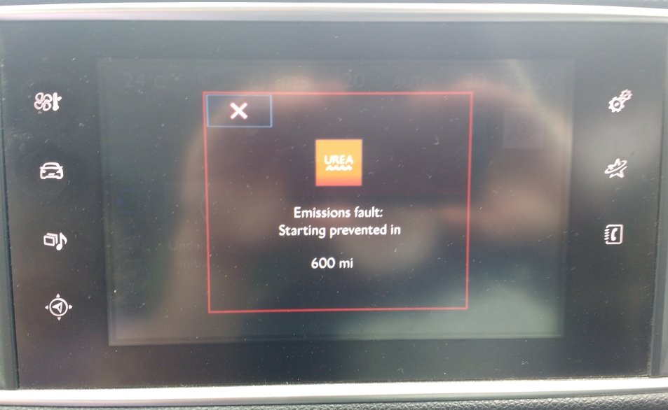

Driving back through France to the UK last week the dashboard, and then the centre display, showed these warnings:
This showed first and then, when the UREA warning light started flashing, these also came up:
At one point this message showed. I had topped the Adblue tank up before we went away and it was still about 2/3 full when we got back:
A few times the warnings would stop displaying and I wouldn't notice that until they restarted. This had the fortunate effect of resetting the "Starting prevented in 700 miles" message as I had worried about not being able to make it back home.

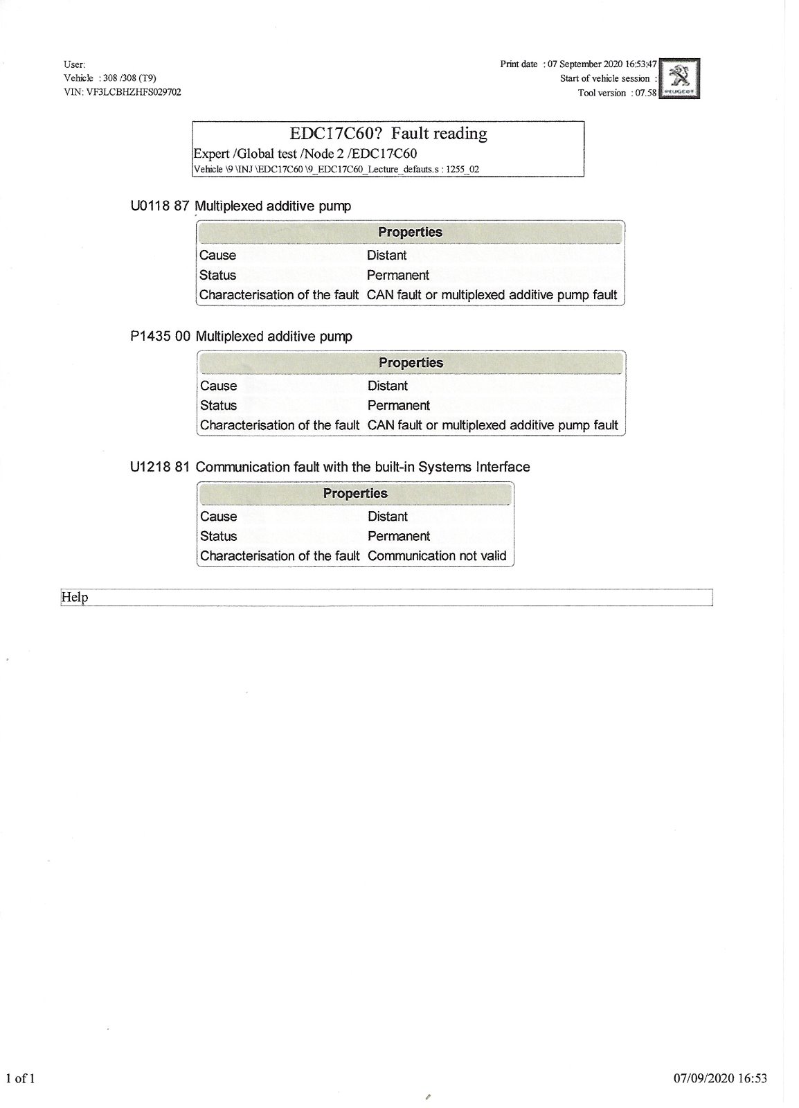

I was able to run the Diagbox a couple of days ago and after clearing the faults and then running the engine these are the faults that came back:
Is this the dreaded Adblue pump failure problem? Or maybe, even though it's not mentioned, the Adblue injector?

I think that you'll find this is the dreaded UREA pump fault and if I'm not mistaken, well-known inside PSA, with their recommended action to replace the whole UREA pump assembly.
I think you'll need to contact the dealer with this one Paul as I don't have the specifics for this engine, but the combination of the U0118 87 and the P1435 00 would certainly indicate this.

I phoned up our local Peugeot dealer to ask how much they would charge to code in a new urea tank if I were to fit it myself and then bring it in. They were aware of the tank problem and told me £50.00 (inc VAT). They then told me that Peugeot had issued "guided support" for vehicles with the pump problem and that they had extended the warranty on the tank from the general 3 years to 5 years/90,000 miles.
In these cases Peugeot would pay for the cost of the tank and the customers would pay the labour cost, which would be £70.00 (inc VAT), which includes coding the new tank to the ECU. Our 308 was 5 years old in April but they suggested that, as that was during lockdown, I should contact customer service and see if they treat us as a goodwill case. Well, the short answer is that they won't because of the car's mileage of 62,000 in 2019.
So I went back to Ebay and priced up tanks. There were several vendors in Europe offering new tanks (correct part number) at priced less than in the UK even including carriage. I now have a tank on its way to us for €600.00 plus €10.00 carriage (£583.51) - considerably less than the UK price.
I had one further idea. I got back in touch with the Peugeot dealer and asked whether, if I supplied a brand new tank, they would fit it for the same price they would have charged me for one supplied under warranty. After a few moments thought the bloke on the desk said they would. So, as coding would have cost me £50 anyway, they would fit it for £20.00. A no-brainer really. Now I just have to wait for the tank to arrive.

The 308 went in today for fitting and coding of the new urea tank. As the MOT was due tomorrow I asked them to do that after fitting the tank, which they said they would do for £40.00. Total cost from the dealer was £110.00 which, with the cost of the tank at £583.51 (€610.00), makes a grand total of £693.51.
Picked it up this afternoon. Their biggest worry was apparently that I would get the wrong tank! All warnings are out and only one advisory (front brake pads needed soon) on the MOT so I'm reasonably happy. We've only travelled a couple of miles home so the big test will be during the next thousand miles or so. Fingers crossed!
I've taken the old tank back so I'm curious to see if there's anything obviously wrong with the pump and/or electronics.
