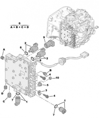

Hello again, Marc. I did manage to source the valve body cover gasket and oil inlet/outlet seals (not shown on this diagram) from a supplier (in Poland!)
The other two seals I was hunting for are shown as part number 8. The ones for the pressure and lock up solenoid shafts.

Ok, so item (8) is the AGB ring seal and is part: 257813 (19,2 X 22,6 - 3,5), however it is no longer available from Peugeot.
You may be able to source a replacement using either the part number or the dimensions though.
