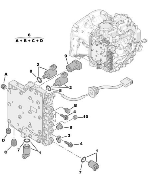

Hello again, Marc. I did manage to source the valve body cover gasket and oil inlet/outlet seals (not shown on this diagram) from a supplier (in Poland!)
The other two seals I was hunting for are shown as part number 8. The ones for the pressure and lock up solenoid shafts.
- x 6961
Re: AL4 Auto Box - ATF temperature
Ok, so item (8) is the AGB ring seal and is part: 257813 (19,2 X 22,6 - 3,5), however it is no longer available from Peugeot.
You may be able to source a replacement using either the part number or the dimensions though.
