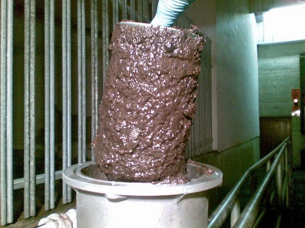

May be worth extracting the pump to check it Roger. They are known to clog with biomass that grows in the diesel, especially when that car is not run for a few months and the fuel continually replaced. I's a bit of a bugger to get rid of.
Somewhere there ia a photo of an actual Xantia pump clogged with it but this will give you an idea of the problem:

That's a PROPER bacterial infestation! WOW!
Fuel has been out before and it is clean.
