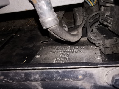

Here's my vin tag, it's a 93 1.9 TD manual right hand drive.

Thanks for posting the VIN.
It must be your lucky day (by the looks of it) . . . that Supply Pipe Front Suspension is pt.no. 5270 EE, is showing still available from Citroen.
Diam = 3.5mm, L = 2437mm.
Use a drenching in penetrating oil, and a single-hex flare nut spanner (8mm iirc) to avoid rounding off the union nuts.
