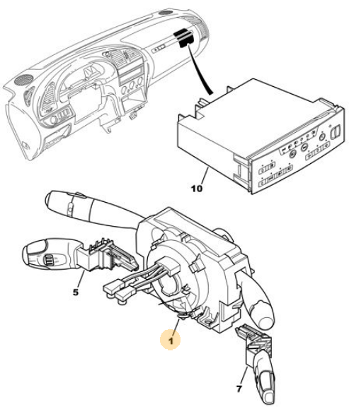

Ok, so the Comms unit is part number: 96787362XT
It sells for £384.53 inc. VAT. from Citroen, but if you look at this place (link below) and search on that part number, you'll find a choice of new or reconditioned units at far less cost:

Thanks very much for the info I will look into getting a cheaper recon unit for sure, I took my switch covers off this morning and saw a sticker on top with the numbers 96511187XT so it looks like it’s been changed before 😮
x 6945
Re: Citroen xsara saloon lights turning on by themselves and no rear fog light
I know that part you quoted was fitted to a 407 and the Xsara (non-Picasso), at some point, but that actual part is not currently listed. It is possible that the number you have is the long manufacturer part number equivalent of the original PSA part number. It's been superseded now anyway for the number I have given you, so you'll be ok with that. :)
£90 for a refurb or £160 for new isn't bad over the PSA price.
I would be wary of second hand parts on the bay or from breakers when it comes to these though, as you really don't know what you are getting and how worn the internals are / clockspring wiring especially.
