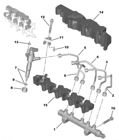

As for your injectors:
Your 3008 was originally fitted with Continental Injectors.
The latest part numbers for these are: 9802448680 for a brand new - £459.10
They do an exchange version for a bit less: 1608518380 - £364.68
These are Peugeot prices as of today and include VAT. But at least you have the part numbers to search on.

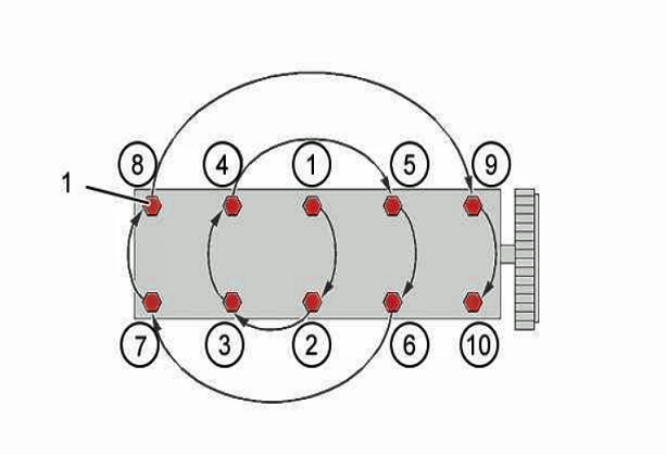

Tightening Torques DV6C:
ReferenceDesignationStageTightening torque
(1)bolts (Cylinder head) (*)Pre-tighten
Tightening
Angular tightening
2 daNm
4 daNm
260°
(2)bolts (Rear upper timing cover ) (*)Tightening1 daNm
(3)bolts (Oil trap) (*)Pre-tighten
Tightening
0,5 daNm
1,3 daNm
(4)bolts (Camshaft bearings covers) (*)Pre-tighten
Tightening
0,3 daNm
1 daNm
(5)bolts ( vacuum pump)Pre-tighten
Tightening
0,5 daNm
1,8 daNm
(6)bolts ( vacuum pump)Pre-tighten
Tightening
0,5 daNm
2 daNm
(7)bolts ( lifting bracket )Tightening2 daNm
(8)nuts (Exhaust manifold heat shield)Tightening0,8 daNm
(9)nuts (Exhaust manifold)Tightening2,5 daNm
(10)studs (Exhaust manifold)Tightening1 daNm
(11)Pre-heater plugsTightening0,6 daNm
(*) Follow the tightening sequence
