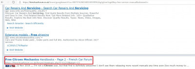

Was going to suggest you to look at the Free Service Manuals for your car or something with the same engine, but I don't have access to the PDFs anymore
Is it related with the making of a donation or?
BR
Martin

? explainksanturion10 wrote: 21 Jul 2020, 01:03 Was going to suggest you to look at the Free Service Manuals for your car or something with the same engine, but I don't have access to the PDFs anymore.
BR
Martin

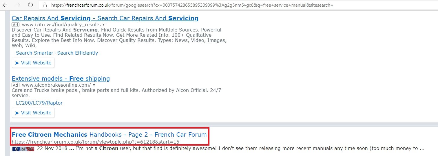

ksanturion10
- Posts: 228
- Joined: 14 Oct 2018, 21:59
- x 19
Re: Xsara 2litre HDI crankshaft Pulley
Still it could be useless
, but I don't have access to this topic anymore:
Can you reach it?
EDIT: Yup, it seems you should make a donation first. I have the S2 Xantia .pdf, but it is on my other PC, which is a little bit duff right now

Citroen have now made access to these handbooks chargeable - like the live parts data, so we have had to move them to the resources section which is available to members making a parts donation.
