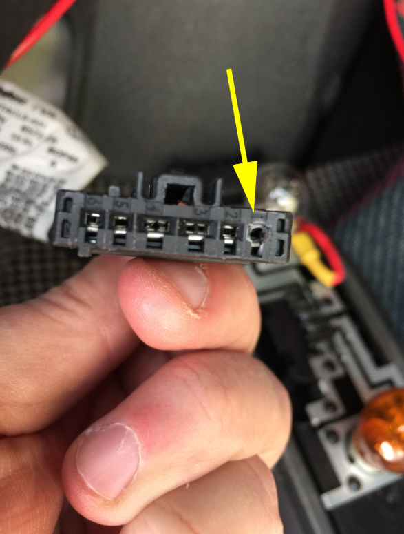

Focus on the Pin assignments, not the wire colours as these can change.
Rear Light Cluster on the body:
Note the Common Earth is on Pin 3:
Brake:
Pin 2 Live
Reversing:
Pin 1 Live
Rear Tail / Side Light:
Pin 5
Indicators:
Pin 4
Fog Lamps These I believe are in the bumper area and these are on Pin 1 and the Earth on Pin 2.

Re: 2010 citroen c4 grand picasso towbar
Post by GiveMeABreak »
The pin numbers are marked on the black wiring plugs if you look carefully. As I said - the colours of the wires are often changed on PSA cars, so may not correspond. Always use the pin number as that is 100% accurate.
Look here for the numbers:

Thank very very much. I had been look and look at wiring diagrams. and in some cases there were multiple wires going through a connection pin the same colour. Your pin number System has solve the problem.
Just as an extra,
I want to put in daylight running lights and an indicator repeater at the front. Therefore one would just look for the plug pin numbers assuming pin number 4 again would be the indicator at the front of the car.
