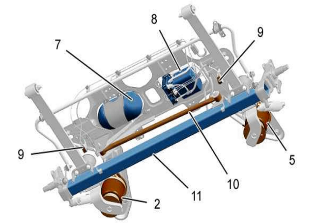

My first thoughts are possibly the rear height correctors. These are exposed to the elements and can suffer with corrosion / water ingress or the internal tracks can just wear out over time. The vehicle is 10 years old now, so one or more of those may be a problem. If these are faulty, then the ride height data cannot be corrected and this will stop the vehicle being raised and lowered (as a safety feature). But this is purely a guess at this stage. Somebody with Peugeot Planet 2000 / Diagbox will be able to read any fault codes and also undertake a Global Test and undertake actuator tests on the system.
Here is a diagram for you showing the components. As you can see it has conventional dampers and a set of pneumatic springs:
Your generic OBD reader may not be able to read codes from the suspension ECU, and that is why they may be missing. I would suggest you get it to somebody with PP2000 / Diagbox kit that also has the specific S1279 module needed to read some commercial vehicles like the Boxer (as this has the Ford Puma Engine).
| (1) Anti-roll bar (2) right-hand pneumatic spring (3) Heel bump stop (4) Air compressor filter (5) left-hand pneumatic spring (6) damper. | (2) right-hand pneumatic spring (5) left-hand pneumatic spring (7) Compressed air reservoir (8) Air compressor (9) Body height sensor (10) Stabilising bar (11) Rear axle crossmember |

Jiggled some wires and wiggled the body height sensor and the compressor started working and raised it up a bit. thanks so much for the diagram
Buttons in front still not working and same message on dash when I start it up but at least it doesnt look like the wheels are going to rub now.
