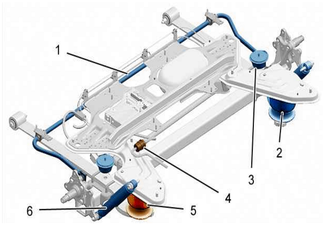

Here is a diagram for you showing the components. As you can see it has conventional dampers and a set of pneumatic springs:
Your generic OBD reader may not be able to read codes from the suspension ECU, and that is why they may be missing. I would suggest you get it to somebody with PP2000 / Diagbox kit that also has the specific S1279 module needed to read some commercial vehicles like the Boxer (as this has the Ford Puma Engine).
My first thoughts are possibly the rear height correctors. These are exposed to the elements and can suffer with corrosion / water ingress or the internal tracks can just wear out over time. The vehicle is 10 years old now, so one or more of those may be a problem. If these are faulty, then the ride height data cannot be corrected and this will stop the vehicle being raised and lowered (as a safety feature). But this is purely a guess at this stage. Somebody with Peugeot Planet 2000 / Diagbox will be able to read any fault codes and also undertake a Global Test and undertake actuator tests on the system.
(1) Anti-roll bar (2) right-hand pneumatic spring (3) Heel bump stop (4) Air compressor filter (5) left-hand pneumatic spring (6) damper. | (2) right-hand pneumatic spring (5) left-hand pneumatic spring (7) Compressed air reservoir (8) Air compressor (9) Body height sensor (10) Stabilising bar (11) Rear axle crossmember |
