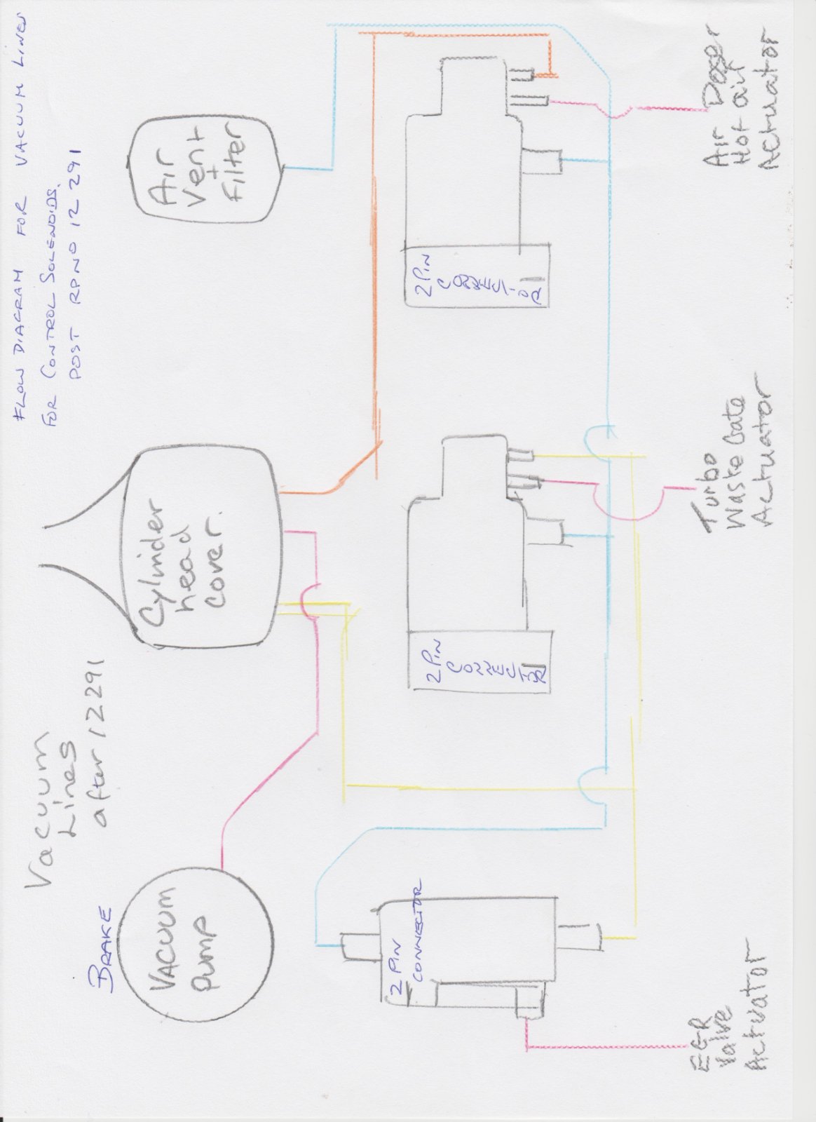

Re: fault code P2425
Here is a diagram done for the Vacuum system involving the 3 control solenoids relating to C5 X7 post 12291
Kenny
