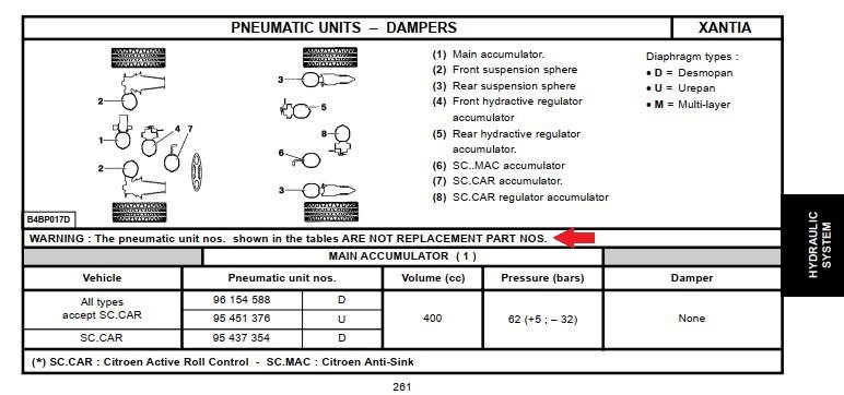

Actually, in this case, I think that 96199318 is the actual Citroen part number.
- x 1751
Re: Sphere Check & Suspension Questions 1999 Xantia Break 2.0i 16V
The Citroen mechanics' booklets caution that the 96... sphere numbers are not Part numbers.xantia_v6 wrote: 16 Jun 2020, 03:59 Actually, in this case, I think that 96199318 is the actual Citroen part number.

That number is a Citroen manufacturing product code, and not a part re-order code.Armidillo wrote: 16 Jun 2020, 09:13 Well people have been using those numbers to identify spheres for quite a while (see post 5)!
viewtopic.php?t=9734
From the Private Cars mechanics' booklets... Annoyingly similar in format to many replacement part numbers, so easily mistaken.
