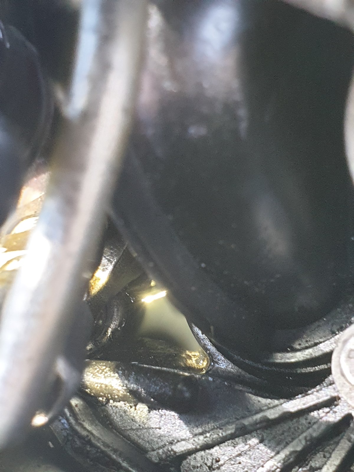

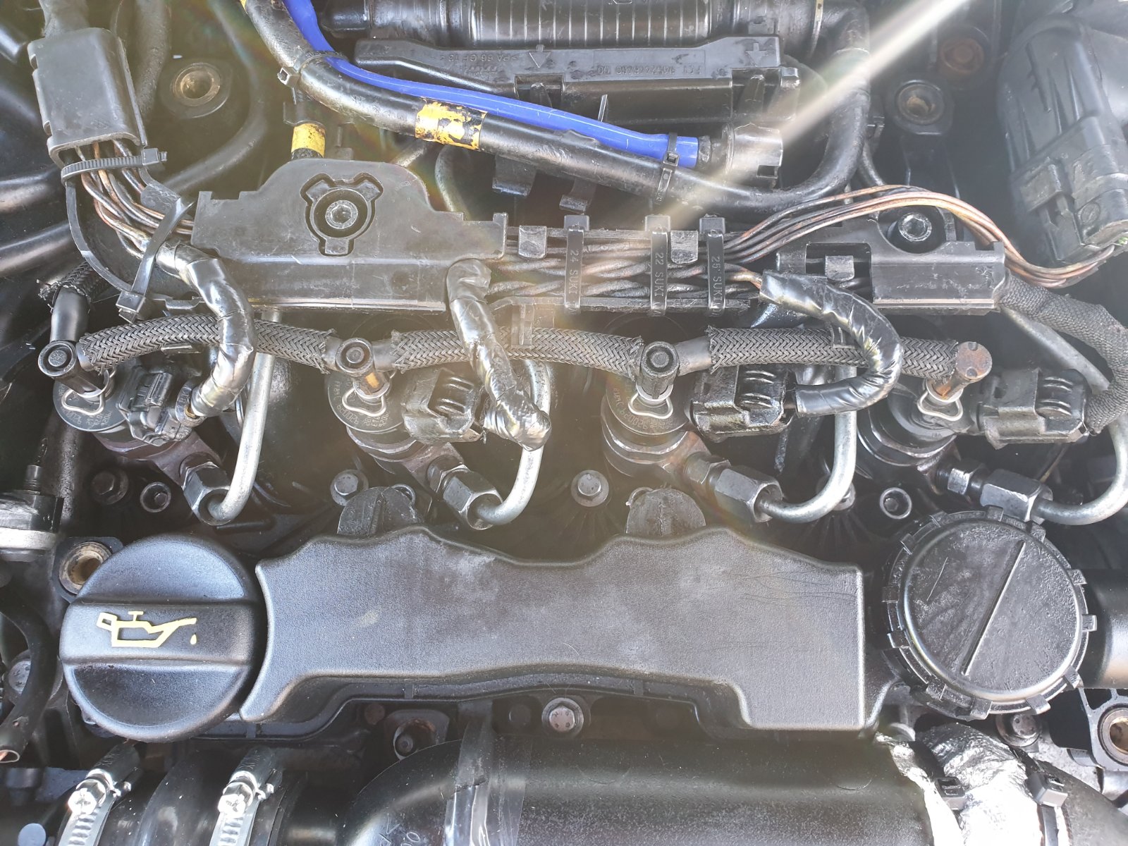

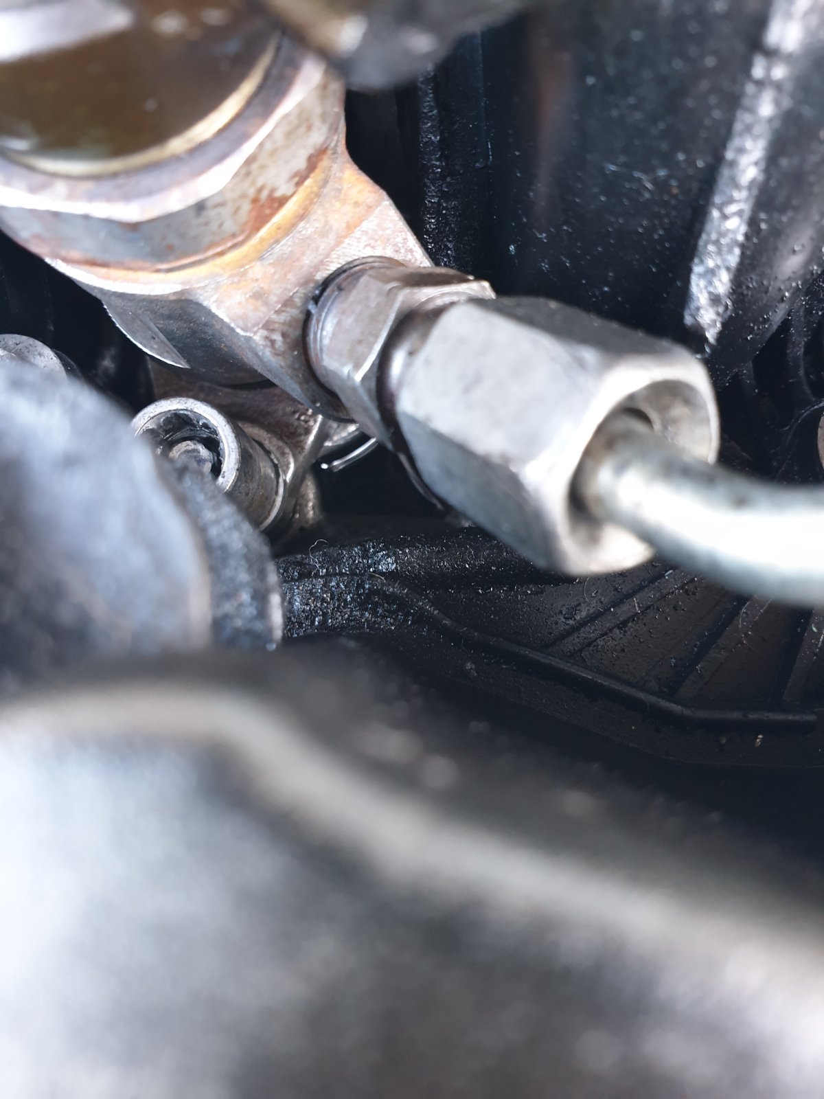

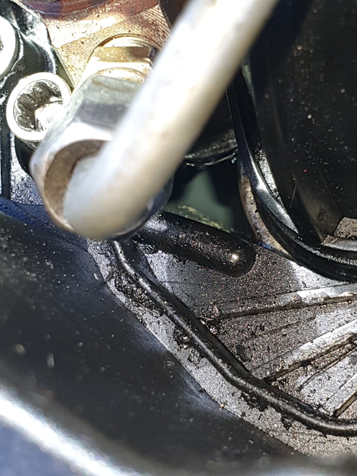

this is how it looks like.....
i have cleaned it . on idle I cant see any leak but after 8 mile drive.....its how it is.
In the picture looks like the injectors are wet on top and around but they arent, its the pic.

The seals are new. and the top of the injectors are dry.

I went to another drive.....i didn't clean it yet...but i had to have another go.....

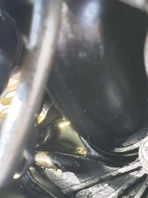

I notice that the injector 1 or 4? (the one close to the vacuum pump) has some wetness.
So i had the engine rev between 2000 and 2500 for 4 min...But nothing came out, or by the feed or return pipes
4 min i guess it would be enough to see if there was leak there?!! The breeder pipe is dry underneath so i can only guess something wrong with the valve cover???

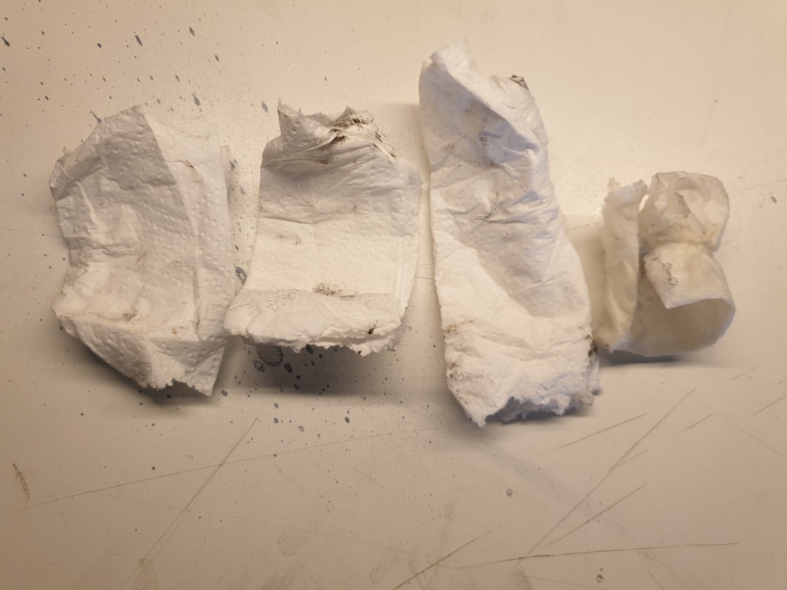

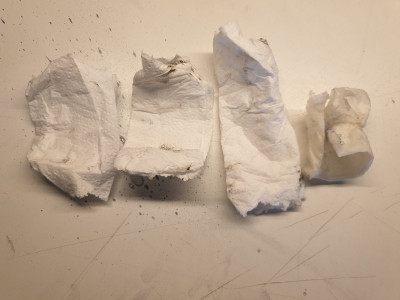

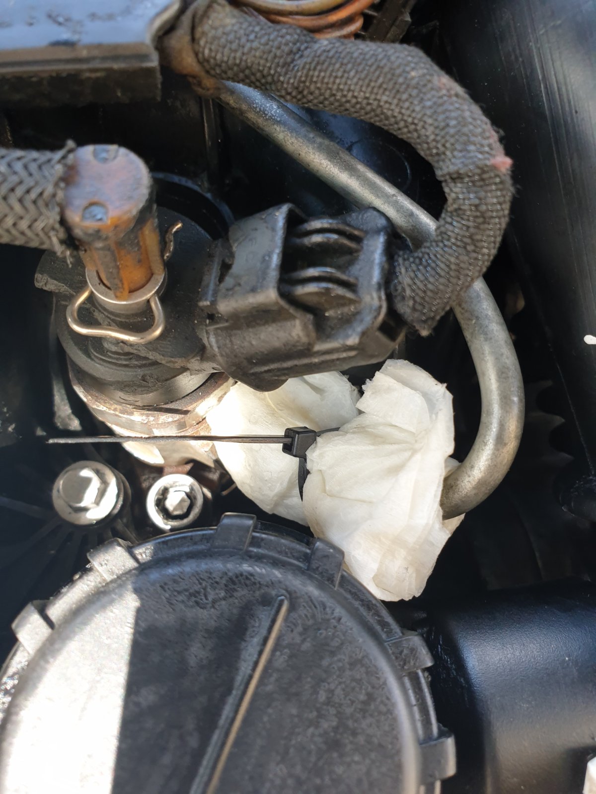

Today after cleanig were the wet was i rap the injectors in paper towels and went for a drive when i return....................

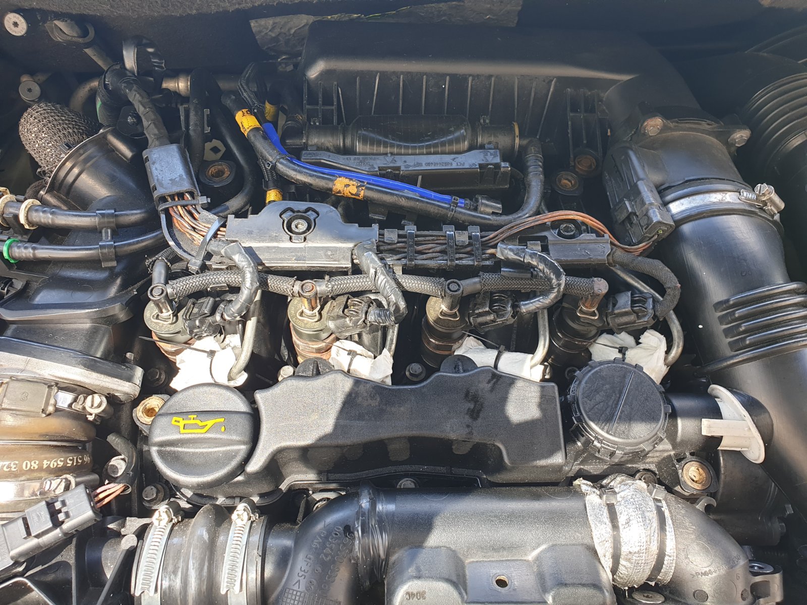

The injector close to the vacuum pump was with the paper towel completely wet in diesel and and everything was dirty again. I dont think its the fuel feeders they are not that tight, If you look at the photo above the injector close to the vacuum pump where the feed pipe is, is not as tight as the others you see more threads, i think thats where the leak is .....
I think i will take it out and use some Teflon tape there......
Below also you can see the paper towel....
Thank you for your help now try to fix it.....without having to buy a new injector
