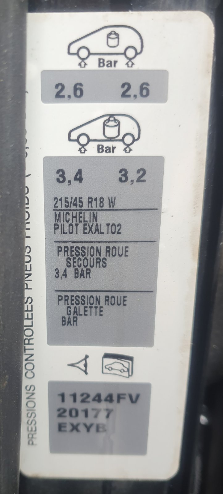

To get a wiring diagram I need the RP number from the tyre pressure label.

Sorry bit to wet down here but is this the info ?
Posts: 14316
x 3298
Re: C4 Grand Picasso 2007 hdi 1.6 auto non crank
11244FV. If the decoder is right your car stated production on 22nd August 2007 in the Vigo factory, Spain

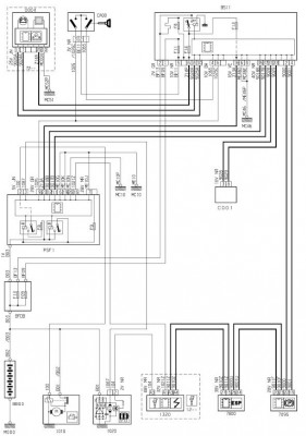

1010 = starter motor
PSF1 = under bonnet fusebox
1320 = injection ECU

Noticed I have power on both sides of fuse 8 starter ? looking at diag! its through an relay would that be part of the BSI ? solid state ? if so would that be the issue

The starter relay is integral to the under bonnet fusebox (PSF1).
Cranking needs to be authorised first though. Does the engine start if you direct feed the starter with the ignition on?
