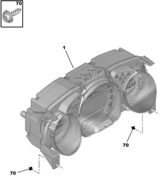

For the latest up to date parts info from Citroen, please see below:

Ok, so you can use either:
Part 6103PT which was the pre-configured instrument panel that would of been originally fitted.
Part 6103PS or the replacement Part: 9809868180 would of been the part ordered that needs configuring to your car.
So any of these part numbers.
The 6103PT and 6103PS numbers are PSA references if being ordered from Citroen and may not have this part number stamped on the unit. If you are interested in or have bought one already, locate the long 98******** number and let me know what it is and I can tell you if it is correct or suitable.
If you get a used one that is different, it may need configuring with Diagbox. I can help you with setting the correct parameters up, if you have access to Diagbox.
Whatever you do - be very gentle with your original as these are about £880 to replace new minus fitting. But these rarely have any issues so I think your problem may lie elsewhere to be honest.
