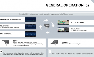

Well according to your manual (PC NAV) it should be available:
Has any other equipment been installed into the vehicle?
