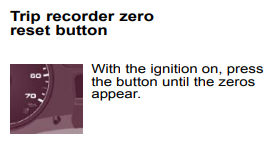

As far as I can tell (and I can't be certain without your VIN) your trip option is this!:
marroko
- Posts: 19
- Joined: 31 May 2020, 11:48
Re: RNEG on Partner 09
Isn't this just to record the number of km in a trip?

I tried to do that, I have two buttons there (one seems to be only for the brightness of the panel). I pressed the other one and a countdown appeared, it seems the only thing it did was reset the service number of km.GiveMeABreak wrote: 31 May 2020, 16:31 As far as I can tell (and I can't be certain without your VIN) your trip option is this!:
- x 6959
There's 2 things here using the same button - so don't get them confused.
1) There's the service maintenance reset if you do your own servicing. The way you reset this is to:
- switch off the ignition,
- press and hold the trip recorder reset button,
- switch on the ignition.
The display begins a countdown. When the display shows "=0" , release the button and the spanner disappears.
2) Trip Recorder Reset: Switch ignition on and hold until it zeros.
So yes, it is a basic trip recorder function I'm afraid.
