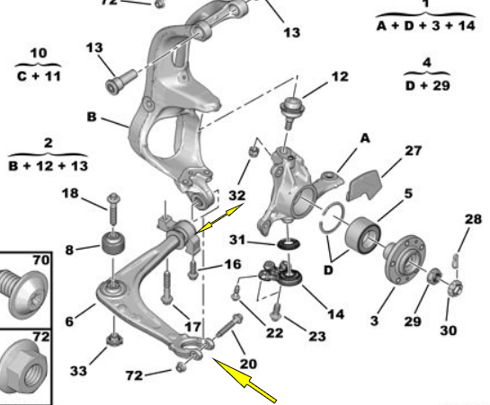

Re: C5 X7 Front Lower Suspension Arm/ Track Control Arms
See my post here:
viewtopic.php?p=644065#p644065
It was impossible to replicate without getting the car off the ground and using 'The Swede' with a crowbar to move it.
It clunks on braking and stopping occasionally - depending on speed / force / etc. I've arrowed in yellow where the movement was on mine that caused the clunking and the bush that needed replacing. These can be bought separately (not from Citroen) and replaced without changing the wishbone.

I tried again this morning and if I lower the car to take some of the tension off the lower arm I can just about see the slight movement in the Pivot Arm Lower Suspension Bush.
So I'm off to GSF to collect a couple of bushes for just over £30 as opposed to £591 garage quoted for 2 new lower arms.
Fingers crossed this works and wish me luck with a "DIY threaded bar and large socket" tool to extract the old bush and insert the new one. :)

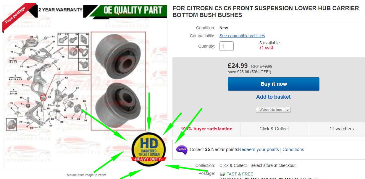

GiveMeABreak wrote: 19 May 2020, 11:17Some Heavy Duty ones here cheaper £24.99 free delivery for the pair.
https://www.ebay.co.uk/itm/FOR-CITROEN- ... 2814670433
I can't see where in the advert it says heavy duty. Are you sure?
Posts: 14318
x 3298
On the bottom right of the picture.

Paul-R wrote: 19 May 2020, 12:06
