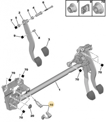

After doing a scan yesterday ive got the P1536 fault code on the EDC16CP39 Brake contact signal, now this is normally associated with my issue so worth looking into , The EDC16CP39 is the main ECU is it not ? on the sub menu Lexia says
Non Coherence between the 2 brake pedal signals
any idea on the part for this is it just the brake pedal switch ?
thanks
Andy
2002 2.2hdi C5
x 6945
Re: C5 X7 Wiring diagrams
The EDC16CP39 is the engine ECU.
Item 10 is the Toe Board Assembly Brake switch. It normally comes as a kit with a modified loom and is part number: 453467.
Eurocarcare do one, that shows the loom £27 inc. VAT.
