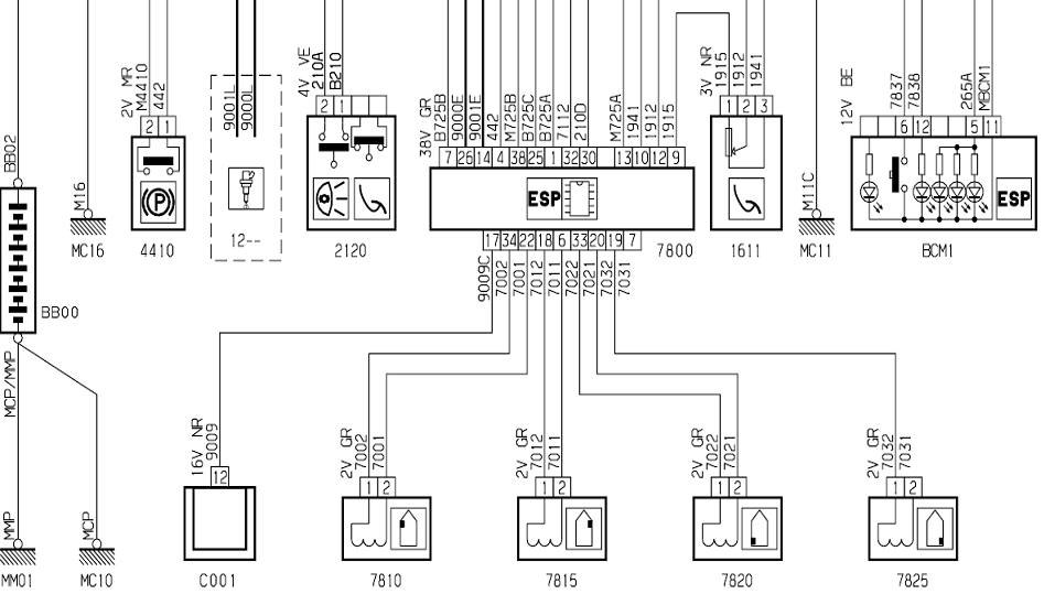

Hi all does anyone have a link to the 2.2HDI 2003 C5 x7 wiring diagram , what I'm wanting to do is look were the 4 wires from the ESP 81 go to to try and track down why I have loads of fault codes , the 4 colours are red, purple, green, brown...

Do you mean for your 2009 2.2 X7? If so, there are many connections - which ones on the diagram are you referring to?
7800 is the ESP ECU.
All the bottoms ones shown go to the sensors and the diagnostic port. Top right connections are to the clutch switch and are combined with others in the 38 pin Grey Plug.
Let me know which pins you are referring to.

Ignore the wire colours, citroen wiring is identified by the code printed along the wire & the pin location in the connector. The code is printed every couple of inches along the wire. The codes are shown next to each wire on the above diagram.

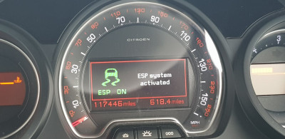

another update on this ive found that if I turn the ignition off then turn the ignition on and start the car all of the faults go and everything works as it should , you can turn ESP off manually and back on and it flashes up green and says ESP activated and hill start works , as long as I don't turn the engine off everything works with no Faults.. so I was thinking .. problem with the BSI, and or issue with the ECU.. is this a checksum problem... what do people think

Marc im a tad confused, why is there 2 ESP … it looks like the gyroscope ecu is BCM1 as thats got 4 wires coming out

The system self-checks on startup. If the self-diagnosis is fine you won't get any errors, that's why. As soon as a fault or condition that can affect the full operation and subsequent safety of the system, occurs, then the ESP will go into a backup mode. The backup mode will deactivate ESP functions, leaving only a rudimentary ABS. This also means crusie control, hill start and emergency dynamic braking via the electronic handbrake will all be deactivated.
There is only one ESP ECU that controls the ESP and the ABS system. BCM1 is the left-hand multifunction switch block.
Here is the full diagram: The ESP ECU is 7800 and 7804 at the top is the ESP accelerometer gyroscope.
