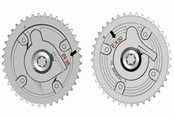

Identification of the camshaft pulleys
Checking the locking of the dephasers

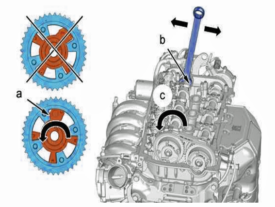

Locking the inlet camshaft dephaser
CAUTION: Do not make the engine turn via the camshafts.
N.B.: The dephaser is locked when the pulley rotates at the same time as the camshaft.
Check that the dephaser remains locked and solid with the camshaft by moving the camshaft gently in the 2 directions (at "b").
If this is not the case, turn the inlet camshaft anticlockwise in the direction of the arrow (at "c") to the internal stop of the dephaser (at "a") (maximum travel 35°).
N.B.: In the event that the dephaser will not lock mechanically, replace the camshaft dephaser (Dephaser viewed from the timing end).

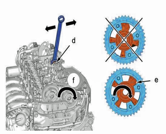

Locking the exhaust camshaft dephaser
Check that the dephaser remains locked and solid with the camshaft by moving the camshaft gently in the 2 directions (at "d").
If this is not the case, action the inlet camshaft clockwise following the arrow ("f") as far as the dephaser’s internal stop (at "e") (maximum travel 30°).
N.B.: In the event that the dephaser will not lock mechanically ; Replace the camshaft dephaser (Dephaser viewed from the timing end).

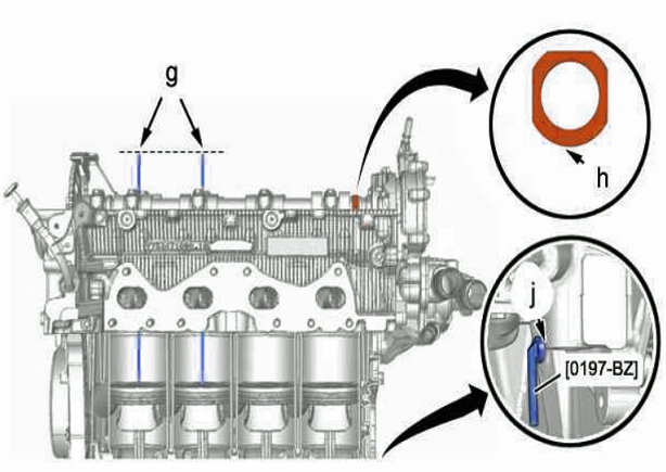

Timing: Crankshaft
CAUTION: When the engine is pegged, the pistons are in mid-travel.
Remove the 2 spark plugs.

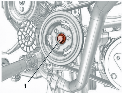

Turn the crankshaft clockwise using bolt (1) to the engine flywheel pinning position: The rounded edge of the camshaft indexing has to be oriented downwards (at "h").
CAUTION: Check the position of the pistons at mid travel using 2 gauges of identical length ("welding rod" type") (at "g"). The rods must protrude by the same length.
Position the rod [0197-BZ] in the location (at "j") situated on the crankshaft main bearing caps casting.
Peg the engine flywheel (at "j") using the pin [0197-BZ].
Check that the engine is pinned correctly by trying to turn the bolt (1) clockwise and anticlockwise, using a pipe spanner.
CAUTION: If the pinning hole is passed, never go backwards; turn the engine clockwise again through 2 revolutions.

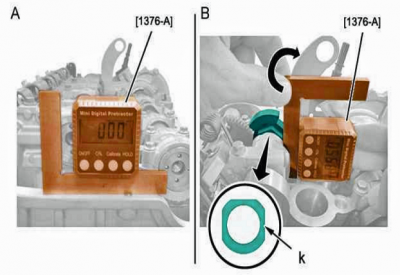

Measurement of the inlet camshaft setting angle
Measurement A: Position the set square type SAM E100 on the cylinder head, timing side.
Position the inclinometer [1376-A] on the set square and set to zero by pressing the "Calibrate" button .
Measurement B: Tilt the inclinometer and the set square by 90° clockwise and set the assembly flush on the vertical plane of the inlet camshaft indexing zone (at "k").
CAUTION: Do not change reference face; do not turn the inclinometer/set square assembly in the opposite direction.

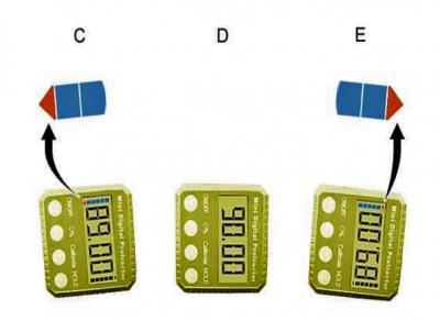

Read the angle given: [89 ; 91°].
If the measurement is not within the ranges above, the setting in not correct, go to stage: "Measurement of the lengthening of the chain".
If the measurement is within the ranges above, the setting is correct, remove the engine flywheel setting rod; Refit.
CAUTION: Follow the instructions for refitting the cylinder head cover at the end of this procedure.
CAUTION: The display of the inclinometer does not indicate a value above 90 degrees.
E.g.: Actual angle "E" = 180 - 89 = 91°.

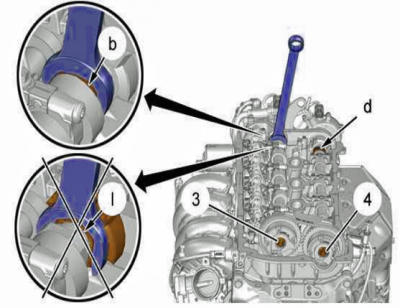

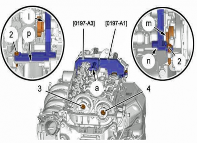

Removal of the camshaft pulley bolts
N.B.: To facilitate assembling of the setting tools, rotate the camshafts slightly (clockwise and anti-clockwise) (at "l","m") using a 27 mm combination spanner.
Assemble the tools [0197-A1], [0197-A3] using the fixing bolt of the tools (a).
Slacken the camshaft pulley screws (3), (4).
CAUTION: Retighten the camshaft pulley screws (3), (4); Reslacken the camshaft pulley screws by 90°; The pulleys should rotate freely but be flush.
CAUTION: Do not hold the camshafts by means of the 27 mm hexagonal spanner (at "l", "m"); Use the flats of the setting zone (at "b", "d").
If the camshaft setting tools [0197-A1], [0197-A3] cannot be fitted. support the camshafts using a 30 mm combination spanner (at "b","d").
N.B.: Operations requiring two operators.
CAUTION: Retighten the camshaft pulley screws (3), (4). Reslacken the camshaft pulley screws by 90° - the pulleys should rotate freely but be flush.

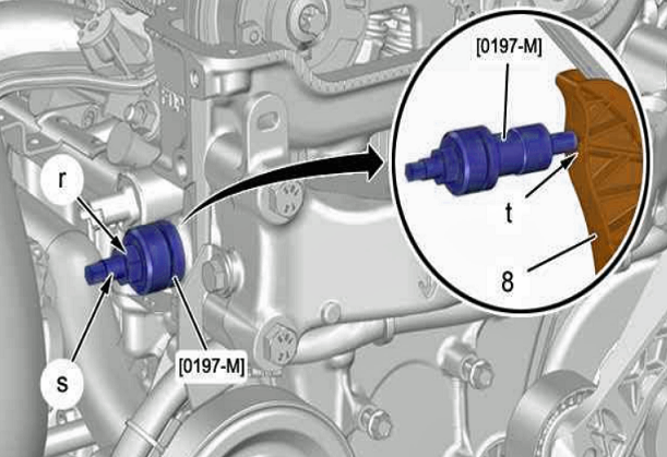

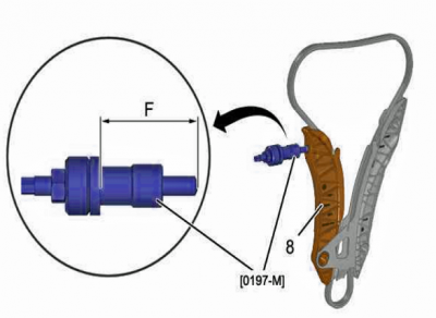

Fitting the dummy timing chain tensioner
CAUTION: Oil the threads of the bolt ("s").
Tighten the body of the dummy timing chain tensioner [0197-M] on the cylinder head .
Tighten bolt ("s") of the dummy timing chain tensioner to the specified torque until it comes into contact (at "t") with the chain tensioner guide (8); Tightening torque: 0,06 daNm.
Lock the assembly by means of a lock nut ("r").
hecking the wear of the timing chain assembly
CAUTION: The timing chain may jump a tooth while you are removing the dummy chain tensioner, if the tools pegging the camshafts [0197-A1], [0197-A3] have been taken away.
Remove the dummy timing chain tensioner and read the dimension "F" between the bearing face of the body of the timing chain tensioner [0197-M] and the end of the bolt ("s").
If the dimension is less than or equal to 73,5 mm: The timing chain assembly has no wear; Apply the repair procedure: Setting the valve timing.
If the dimension is greater than 73,5 mm, apply the procedure "removal-refitting of the timing chain" with its replacement.
N.B.: In the 2 cases, refit the dummy timing chain tensioner [0197-M].

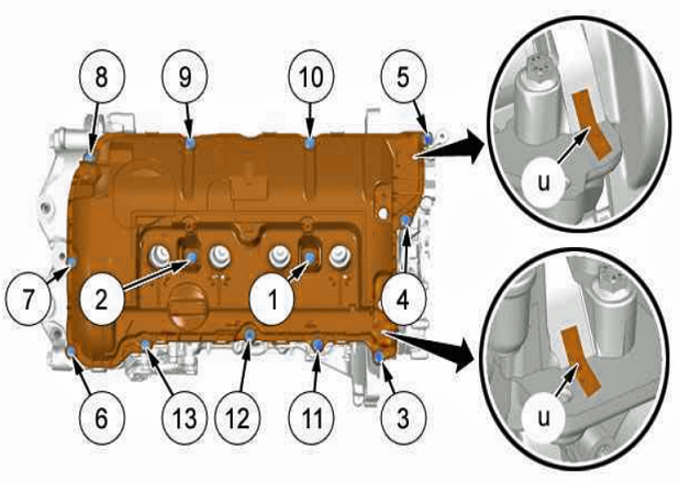

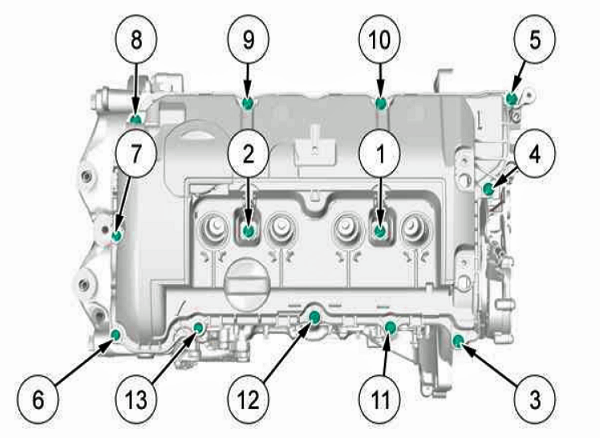

Refitting: Cylinder head cover (If setting correct)
CAUTION: Systematically replace the seal of the valve cover .
Clean the sealing face on the valve cover using a clean cloth.
Clean the old sealing beads (at "u").
Apply a sealing bead 20 mm long and 5 mm wide (at "u") on each side of the double bearing.
Refit:
Refit:
Tightening Torques
Order of tightening: Cylinder head cover
- "C" (Ankle of advance): The value of the inclinometer is equal to the actual angle .
- "D" (Perpendicular angle): The value of the inclinometer is equal to the actual angle .
- "E" (Retard angle): The value of the inclinometer is not equal to the actual angle .
- The inclinometer displays the reverse angle
- The direction of reading of the value is reversed
- The direction of the arrows is reversed
| Position the camshaft setting tools [0197-A1], [0197-A3]. Tighten the tools [0197-A1], [0197-A3], using the bolts (2). The tools must be firmly flush on the cylinder head (at "p","n"). |

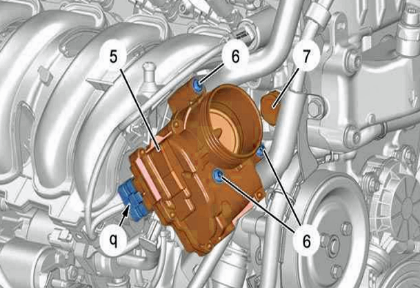

Removing: Timing chain tensioner
Remove:
- The bolts (6)
- The throttle unit (5)
Remove the timing chain (7) tensioner.
Check the condition of the timing chain tensioner (7). Action the piston manually
If the piston is seized, replace the timing chain tensioner (7).
Refit:
- The cylinder head cover with a new seal
- The bolts (Cylinder head cover)
Refit:
- The front right mud guard
- The protective panel under the engine
- The front right wheel
- The vehicle to its wheels
Tightening Torques
| (1) Cylinder head cover securing bolt. |
