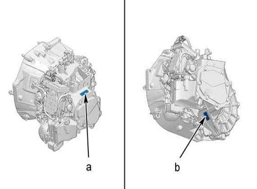

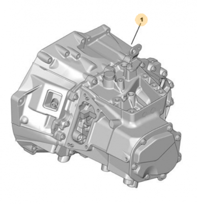

Ok, so the Gearbox for your C4 is a CP 19X71. CP 19X71 relates to the final drive ratio.
It will have one of the following markings, and you have already said yours is a DS21.
DS25 DS81 DS44 DS17 DS01 DS31 DS66 DS35 DS07 (DSDD) DS11 DS21 DS60 DS49 DS06
The PSA part number for the new gearbox was 2231A8. This has since been superseded with replacement part number: 1606977980.
The part number for an exchange box was: 2223ZJ. Again, use the same marking.
Hopefully the PSA part numbers I quoted above will help you find a suitable replacement.
I think the variations in the markings may be linked to the different stepping of the gearbox.
| Research type | Legislation type | Stages | Final drive | differential | Speedometer take-off |
| DV6TED4 | 9HZ | MCP/6D | 19x71 | 77 | Without |
| "a" Identification label. "b" Location of engravement of serial no. and plate. |

Thats great, thanks Marc. So from what I can see a gearbox from a picasso is not going to be suitable as they all have differing DS numbers/drive ratio - will continue to search through the breakers for a hatchback one. Thanks again and indeed a great movie!
- x 6963
Re: C4 semi auto gearbox
No problems - if you Google 'Citroen 2231A8' you should find quite a few available - though not cheap.
