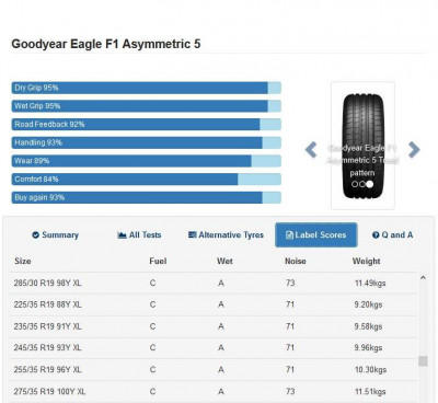

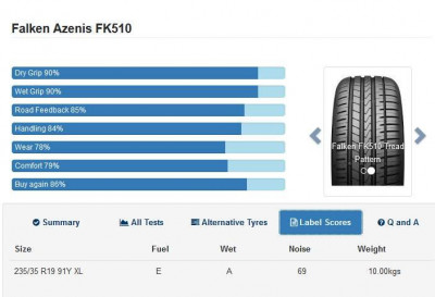

It'd depend on which spec Goodyear you were looking at, but comparing like-for-like, the Falken is quieter.
https://www.tyrereviews.co.uk/Tyre/Falk ... -FK510.htm
https://www.tyrereviews.co.uk/Tyre/Good ... tric-5.htm
