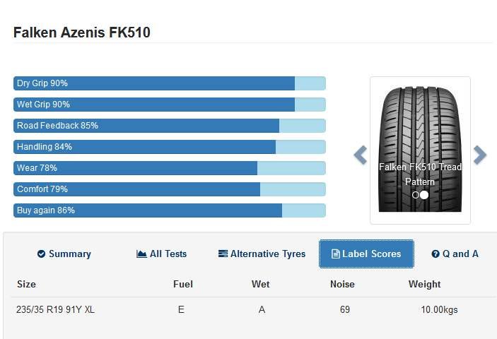

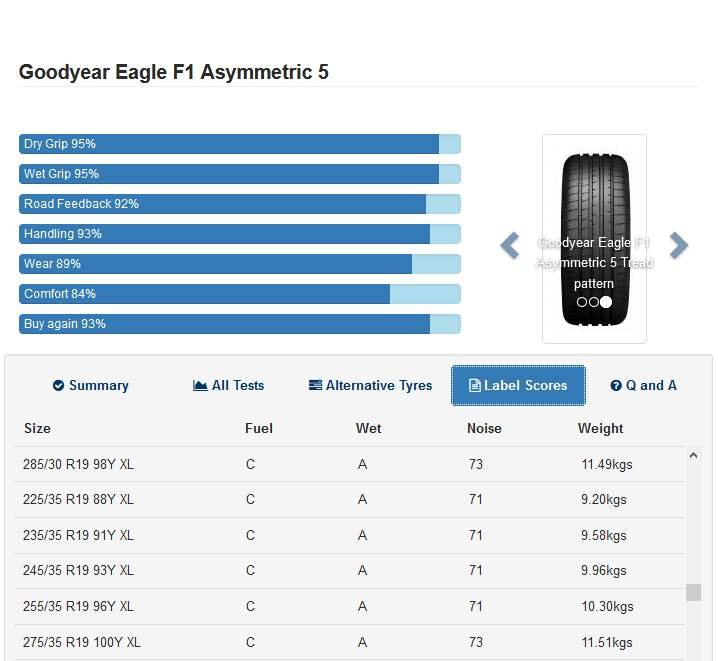

- Posts: 6847
- x 3565
Re: Citroen C5 X7 mk3 hydractive suspension (updated due to fitting new tyres)
It'd depend on which spec Goodyear you were looking at, but comparing like-for-like, the Falken is quieter.
