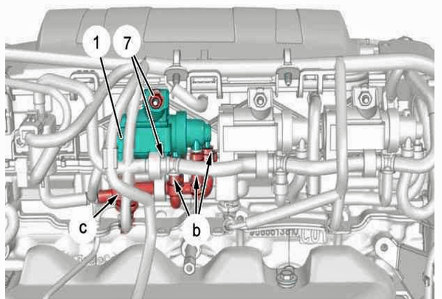

Removing the Control Solenoid Valves (Turbocharger, Inlet Air Mixing, Inlet Air Cooling & EGR) on a DW10CTED4 C5 X7

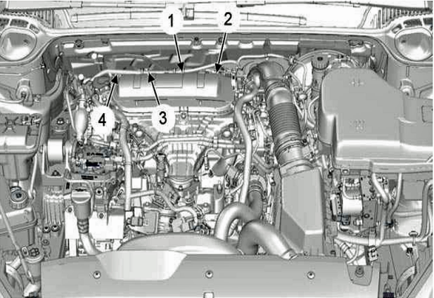

Location Of Valves

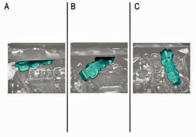

Remove Heat Shield
Turbocharger pressure regulation solenoid valve

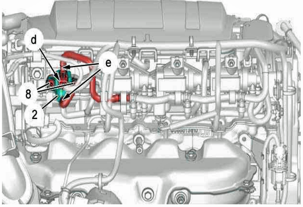

EGR cooling solenoid valve

Location Of Valves
| (1) The turbocharger pressure regulation electrovalve. (2) EGR cooling solenoid valve. (3) Inlet air cooling solenoid valve. (4) Inlet air mixer control electrovalve. |

| Remove the bolts (7). Uncouple and move aside the vacuum circuit pipes ( as "b"). Note: Mark the position of each vacuum pipe! Disconnect the connector (at "c"). Remove the turbocharger pressure regulation solenoid valve (1). Refitting Refit the turbocharger pressure regulation solenoid valve (1). Couple the vacuum circuit pipes ( as "b"). Note: When refitting, do not reverse the vacuum pipes . Connect the connector ( as "c"). Refit the bolts (7). |

| Remove the bolts (8). Uncouple and move aside the vacuum circuit pipes ( as "e"). Note: Mark the position of each vacuum pipe! Disconnect the connector (at "d"). Remove the EGR cooling solenoid valve (2). Refitting Refit the EGR cooling solenoid valve (2). Couple the vacuum circuit pipes ( as "e"). Note: When refitting, do not reverse the vacuum pipes . Connect the connector ( as "d"). Refit the bolts (8). |
