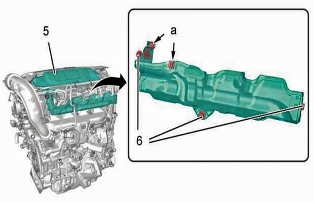

Removing the Control Solenoid Valves (Turbocharger, Inlet Air Mixing, Inlet Air Cooling & EGR) on a DW10CTED4 C5 X7
Location Of Valves
Disconnect the battery following BSI Reset / Battery Disconnect / Reconnect Procedure
Remove Heat Shield

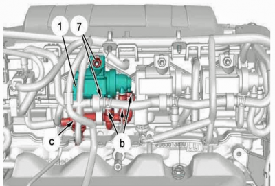

| Remove the bolts (7). Uncouple and move aside the vacuum circuit pipes ( as "b"). Note: Mark the position of each vacuum pipe! Disconnect the connector (at "c"). Remove the turbocharger pressure regulation solenoid valve (1). Refitting Refit the turbocharger pressure regulation solenoid valve (1). Couple the vacuum circuit pipes ( as "b"). Note: When refitting, do not reverse the vacuum pipes . Connect the connector ( as "c"). Refit the bolts (7). |

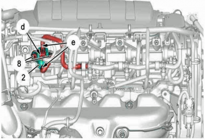

EGR cooling solenoid valve
| Remove the bolts (8). Uncouple and move aside the vacuum circuit pipes ( as "e"). Note: Mark the position of each vacuum pipe! Disconnect the connector (at "d"). Remove the EGR cooling solenoid valve (2). Refitting Refit the EGR cooling solenoid valve (2). Couple the vacuum circuit pipes ( as "e"). Note: When refitting, do not reverse the vacuum pipes . Connect the connector ( as "d"). Refit the bolts (8). |

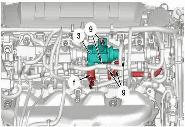

| Remove the bolts (9). Uncouple and move aside the vacuum circuit pipes ( as "g"). Note: Mark the position of each vacuum pipe! Disconnect the connector (at "f"). Remove the inlet air cooling solenoid valve (3). Refitting Refit the inlet air cooling solenoid valve (3). Couple the vacuum circuit pipes ( as "g"). Note: When refitting, do not reverse the vacuum pipes . Connect the connector ( as "f"). Refit the bolts (9). |

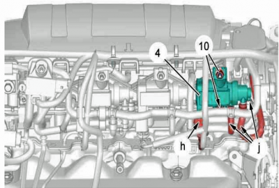

Inlet air mixer control electrovalve
| Remove the bolts (10). Uncouple and move aside the vacuum circuit pipes ( as "j"). Note: Mark the position of each vacuum pipe! Disconnect the connector (at "h"). Remove the inlet air mixer control electrovalve (4). Refitting Refit the inlet air mixer control electrovalve (4). Couple the vacuum circuit pipes ( as "j"). Note: When refitting, do not reverse the vacuum pipes . Connect the connector ( as "h"). Refit the bolts (10). |
