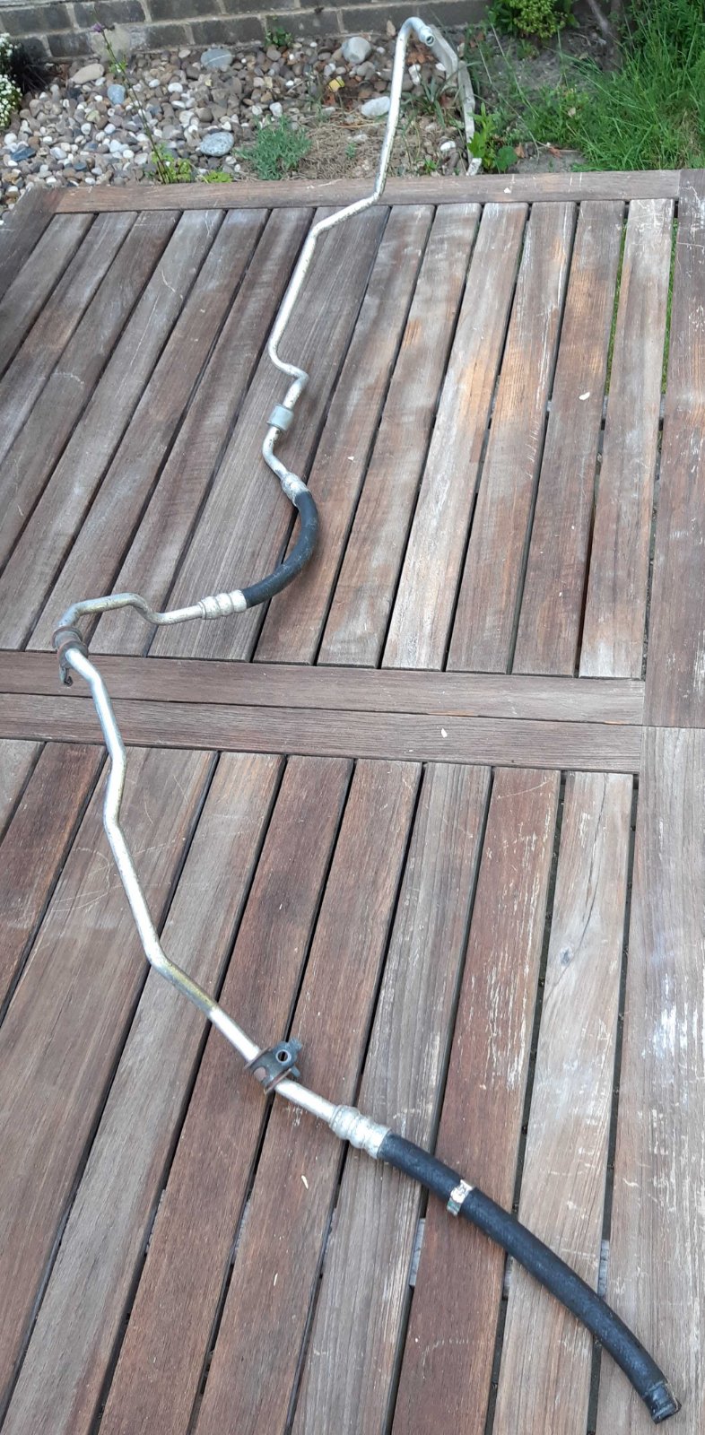

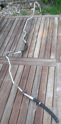

I've just been out to measure them, and the O.D. of the aluminium pipe is about 12.2mm, and the O.D. of the steel pipe is around 10.1mm. These are the O.D.s of the pipe runs and not the O.D. of where the pipe enters the pinion housing.

I'm primarily putting these here for Kenny's benefit, but feel free to play along at home as well

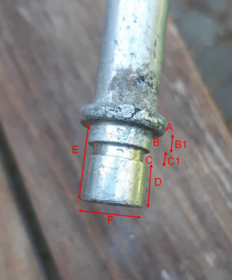

Aluminium Pipe Dimensions: A: Swage Dia 16.70mm
B: Pipe Dia (same as F) 11.95mm
B1: Section Length 3.30mm
C: 'O' Ring Groove Dia 9.45mm
C1: 'O' Ring Groove Width 2.45mm
D: Section Length 8.60mm
E: Overall Length to Base of Swage 14.00mm
Steel Pipe Dimensions: G: Swage Dia 14.90mm
H: Section Length 3.70mm
I: 'O' Ring Groove Dia 8.30mm
I: 'O' Ring Groove Width 2.78mm
J: Overall Length to Base of Swage 11.58mm
K: Section Length 5.10mm
L: Pipe Dia 10.95mm

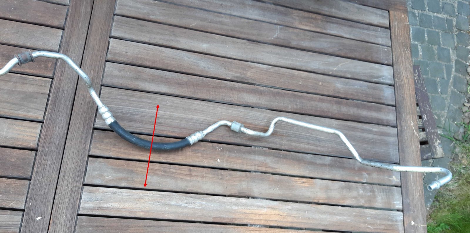

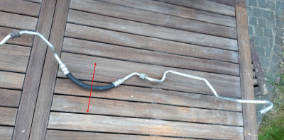

I mentioned previously that it is possible to split the Aluminium pipe near to the front left corner of the car so you only have to replace part of the pipe. It splits at a hose clip where the flexi hose attaches to the rigid pipe. Here's what the shorter (i.e. not the whole pipe as purchased from Citroen) length of pipe looks like:
It might be possible to get a pipe fabricator to make up an even shorter length of pipe and split and join in the new section midway along this section of flexi pipe:
Edited to correct measurement 'B'
L: Pipe Dia 10.95mm

Really helpful, Robin.
What was the diam of F, in the first photo? Same as L?
And what is the diameter of the bores in the casting - both the same?
- Posts: 6847
- x 3565
Re: The curse has struck again
F is same as B - 11.95mm
