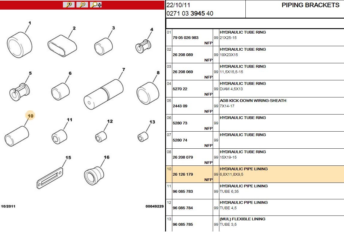

The tubular hydraulic pipe seals were used on 3,5, 4.5, and 6.35mm pipe, with swaged olive.
These are the seals (#10,11,12,13 Hydraulic Pipe Lining) There's also a 9.5mm one listed there, but I can't picture a 9.5mm pipe (on XM, at least) which uses this sort of sleeving. There are 10mm pipes on the Hydractive suspension (eg at the sphere mounts), but they use a different arrangement, and a 13-14mm thread. Maybe someone else can think of a 9.5mm sleeved item on one of our cars.
