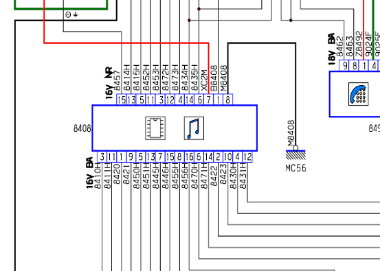

- Posts: 42019
- x 6955
Re: Citroen C5 Mk I original JBL amplifier.
Here's the same system on a 407 (2006): The Body VAN 2 connection is pin 7, so probably a CAN VAN system.
wheeler
- Posts: 7894
- Joined: 21 Sep 2002, 19:07
- x 1044
Yes that's a Bi VAN/CAN system that would also be found on a mk1 C5.
Wire XC2M is whats known as a VAN+ supply, this is just a 12v supply that is powered when the network is awake, almost like a switched feed, this is the equivalent of the CAN+ supply on the other diagram. If you wanted to wire this to another car this would just be substituted for an ignition live supply. The multiplexed data wires on this system always start with the number 9 and are in pairs. As you can see there are none connected to the amp, you can just see them on the handsfree unit on the right of your diagram.
