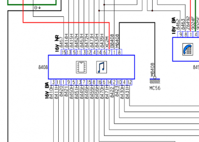

The Diagram below is from a mk2 (Full CAN) C5. Apart from the speaker inputs & output there are only 3 other wires. An earth, a switch on signal from the radio & a power supply from a relay that is switched from (not powered from) a CAN+ supply.

Here's the same system on a 407 (2006): The Body VAN 2 connection is pin 7, so probably a CAN VAN system.

Yes that's a Bi VAN/CAN system that would also be found on a mk1 C5.
Wire XC2M is whats known as a VAN+ supply, this is just a 12v supply that is powered when the network is awake, almost like a switched feed, this is the equivalent of the CAN+ supply on the other diagram. If you wanted to wire this to another car this would just be substituted for an ignition live supply. The multiplexed data wires on this system always start with the number 9 and are in pairs. As you can see there are none connected to the amp, you can just see them on the handsfree unit on the right of your diagram.

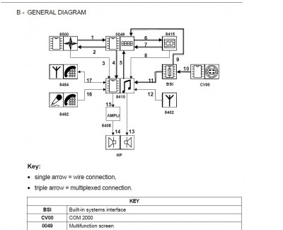

The diagram below is from the MK1 C5 audio training manual and shows the electrical layout of the audio system, this too shows that the amp is connected by a wire connection rather than a multiplexed connection.

Great, good to have the clarification.
