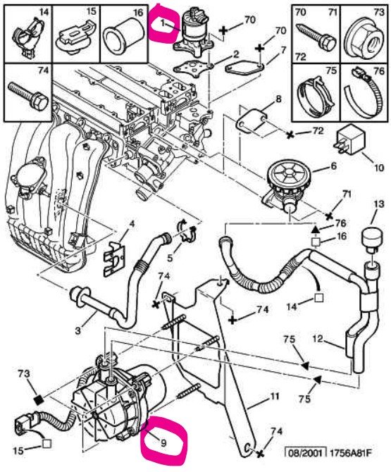

No I'm not talking about the brake servo but secondary air pump location.
My car is CITROЁN C5 II Hatchback 2.0 16V 2006 Petrol 103 kw
Here's a pic of an air pump which has got something to do with the antipollution system.

Re: C5 Secondary Air Pump Location?
Post by wheeler »
If it has a secondary air pump fitted it will be behind the LH front wheel arch liner under the headlamp. There should be a one way valve fitted to the exhaust manifold with a pipe leading to the pump if it has an air pump fitted.
Post by Clogzz »
I have that pump, it’s under the battery.
It stopped pumping years ago.
Since I didn’t know if it was seized or had worn brushes, I pulled the fuse out so that it couldn’t cause me troubles.
The only difference since is that the exhaust has a grotty stench :evil: when the engine is cold.
Bed time :zzz: here, will be back tomorrow with the fuse number.
Edit: Under bonnet fuse F16, 30A green, for "air pump".
Post by wheeler »
I've had a good look too for the mk2 & cant find it, there only seems to be one choice of 2.0 petrol engine on the mk2 & its not showing as having the air pump or EGR (which I find bizzare).
I can only see them on the mk1 below.
Out of curiosity why do you need to locate it?
