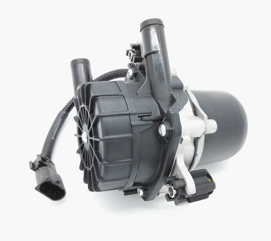

No I'm not talking about the brake servo but secondary air pump location.
My car is CITROЁN C5 II Hatchback 2.0 16V 2006 Petrol 103 kw
Here's a pic of an air pump which has got something to do with the antipollution system. -Nea-
Marc@

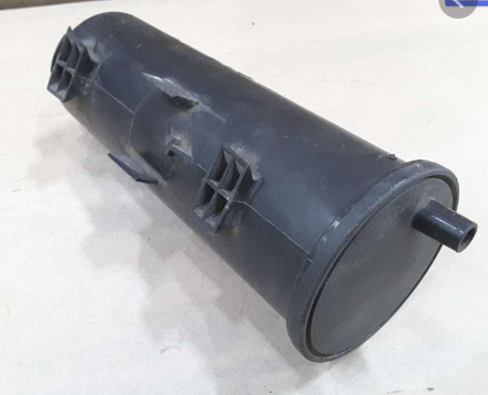

Yes, I have your car correct, but there's nothing like that I can see - where did you get that picture as I can't see anything like it on your engine.
The only thing related to the emissions, is the fuel vapour canister absorber - but that is nothing like the above picture.
The fuel vapour canister is like the picture below and that is connected to an electrovalve.
So can you be more specific in what it is you are looking for - what is its purpose?

If it has a secondary air pump fitted it will be behind the LH front wheel arch liner under the headlamp. There should be a one way valve fitted to the exhaust manifold with a pipe leading to the pump if it has an air pump fitted.

I have that pump, it’s under the battery.
It stopped pumping years ago.
Since I didn’t know if it was seized or had worn brushes, I pulled the fuse out so that it couldn’t cause me troubles.
The only difference since is that the exhaust has a grotty stench when the engine is cold.
Bed time here, will be back tomorrow with the fuse number.
Edit: Under bonnet fuse F16, 30A green, for "air pump".
