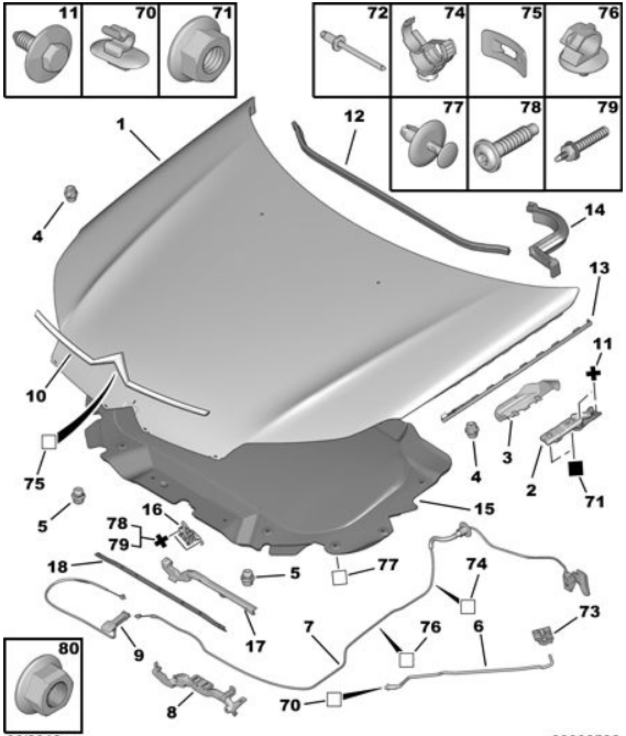

I have the new cable fitted but as it loops in a U there seems nowhere to fit it to take up slack/add resistance. So it doesn't actuate the lock as the cables loose.GiveMeABreak wrote: ↑13 Apr 2020, 15:02 There are 2 parts to the bonnet opening system. The first and most awkward one is the cable release from the interior (that is rarely the problem) and the other part is where you lift the tab from under the bonnet. This is the part that failed with me.
I bought the kit and it was a simple matter of routing it and replacing it all from the front. Taking off the plastic covers on top of the headlamps carefully and then the long black plastic trim above the bonnet release should make it easier to see the routing.
The old one was loose and stretched so no guide to its original fitment. I can see the mark of where something has been snapped off the underside of the plastic nearby where the oil sticker is on the top of the panel.

Have a squiz at my post here:
viewtopic.php?p=595633#p595633
That shows the parts diagram and a few posts down I did a quick (non-instructable) video - just to show the mechanism working - but I did mention there about the routing.

Cheers.GiveMeABreak wrote: ↑13 Apr 2020, 16:42 Have a squiz at my post here:
I can see on your video your cable goes at an angle towards the exact part thats sheared off on mine. That whole area is flat with nothing to route around.
So mine just goes it a loose loop.

Re: 2009 C5. New owner,some issues
Ok, so it may have been in a battle earlier where it has seized up jammed - which may have stressed the routing supports. Can you improvise with some cable ties strategically placed?
Ok, so there are some differences between your model and mine that I think are worth a mention:
You don't have items:
(17) Anti-Intrusion Protector
(18) Engine Bonnet Seal
The only other bit of trim I can see that may have some fixing underneath for the bonnet cable is item (4) which may require drilling of the 3 holes for the fitting of power train trims where applicable, but I can't be sure.
