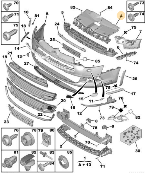

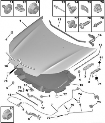

Re: 2009 C5. New owner,some issues
Post by GiveMeABreak »
Ok, so there are some differences between your model and mine that I think are worth a mention:
You don't have items:
(17) Anti-Intrusion Protector
(18) Engine Bonnet Seal
The only other bit of trim I can see that may have some fixing underneath for the bonnet cable is item (4) which may require drilling of the 3 holes for the fitting of power train trims where applicable, but I can't be sure.
