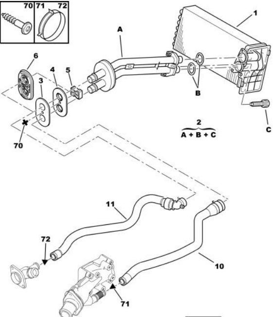

Hi, first post on here.
06 plate 307SW 1.6 Petrol
I replaced the heater matrix some time ago, which was surprisingly easy....until I came to reattach the hoses to the bulkhead pipe stubs. I managed to mangle the horseshoe-shaped clips :x and in the end replaced the pipes with 19mm heater hose and jubilee clips.
I've never been particularly happy with this and would like to refit the original hoses.
A couple of questions if I may:
Are the clips available separately, or are they only supplied with new hoses?
Are the hoses refitted to the pipe stubs with the clips in-situ?
Many thanks,
Stan

Re: 307SW Heater Hose Clips
Ok, thanks for that Stan.
Here is the information you need:
Item (10) is the inlet pipe. Part number: 6466FW (£41.09 inc. VAT)
Item (11) is the Return Pipe. Part Number: 6466F7 (£47.56 inc. VAT)
Prices correct as of today direct from Peugeot or Citroen, although bear in mind they are also in lockdown at present.
(note: you don't have part (6) in the diagram fitted - just in case you are looking for it.).
