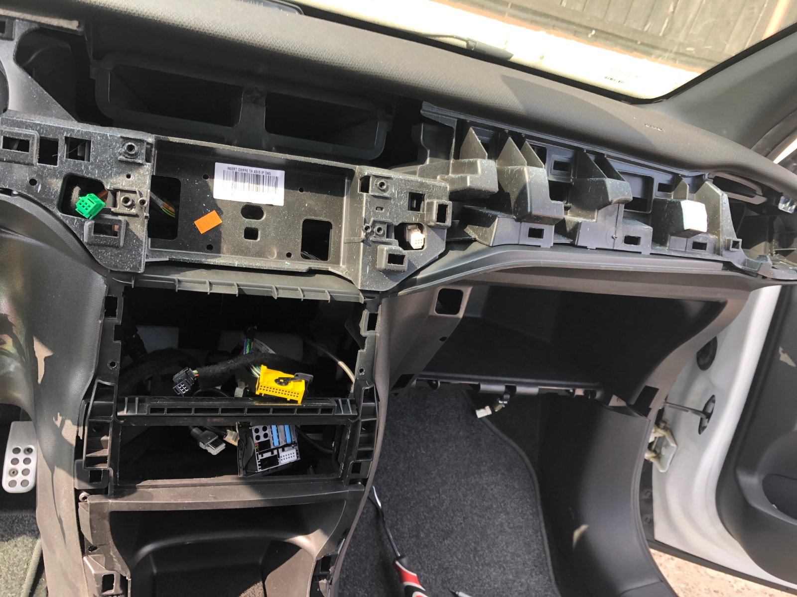

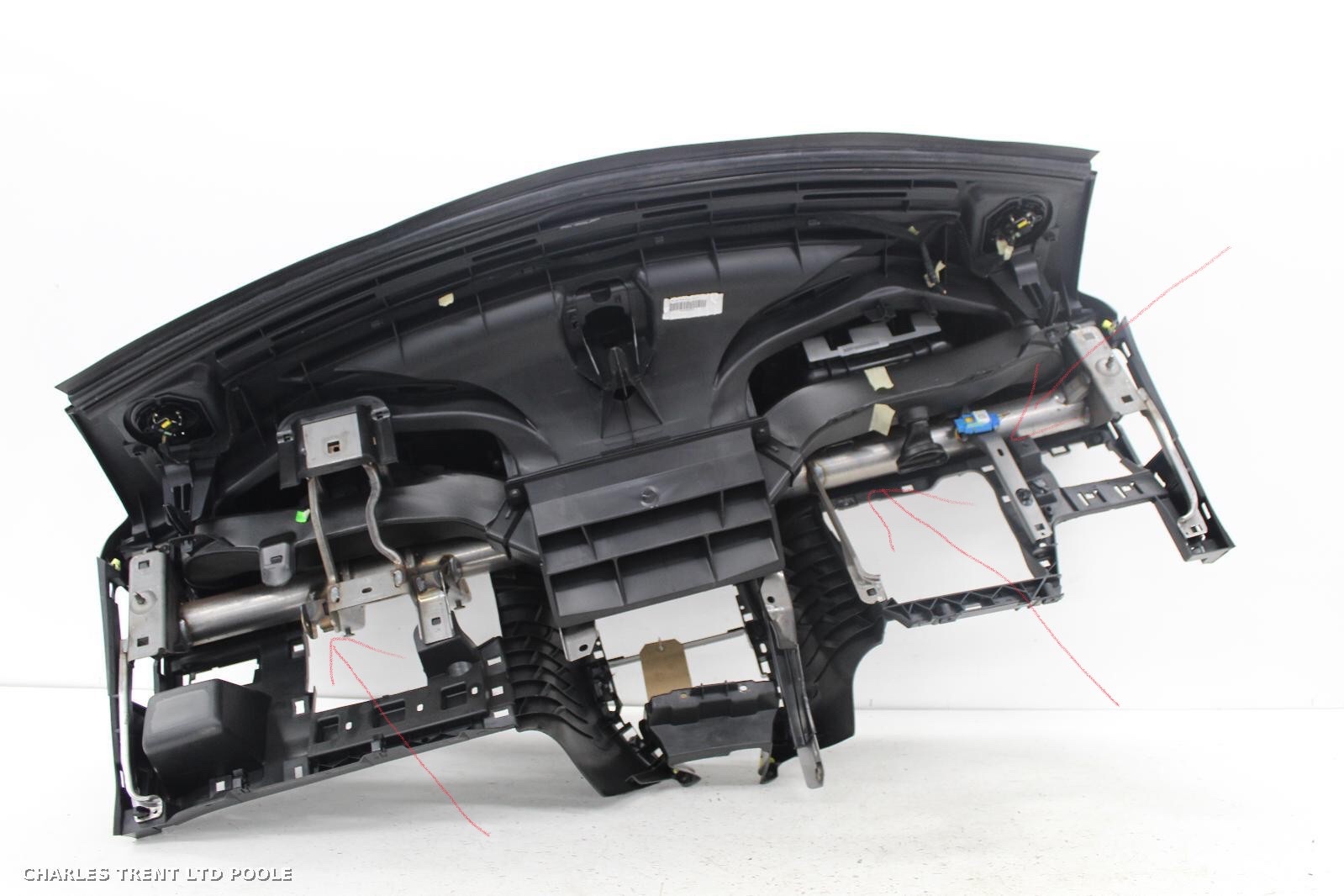

Here an example. Actually this metallic structure is somehow part of the dash, the steering column is screwed on it and the dashboard itself is screwed from the inside on it.
Yesterday when I bought the heater module the dash was removed without the reinforcement and broken.
x 6955
Re: Citroen DS3 A/C Evaporator leak
Ok, I'll put something up now - that's the dashboard crossmember.... give me a few minutes.
x 6955

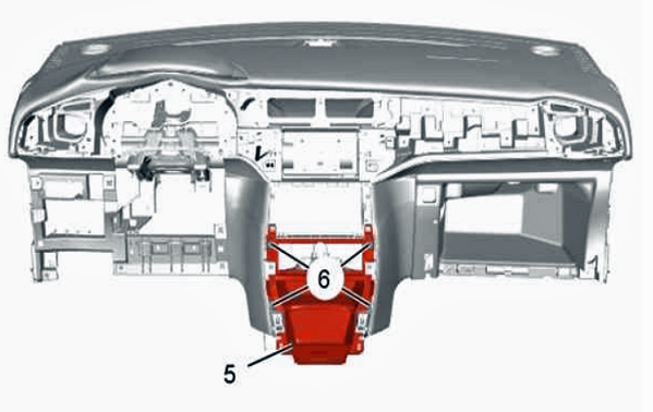

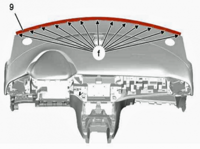

Ok, here is the procedure I think you need:

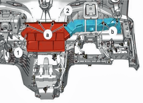

Unclip: The air duct (2) ( as "b") using trim tools.
Remove: The air duct (2).
Unclip: The air duct (1) ( as "a") using trim tools.
Remove: The air duct (1).

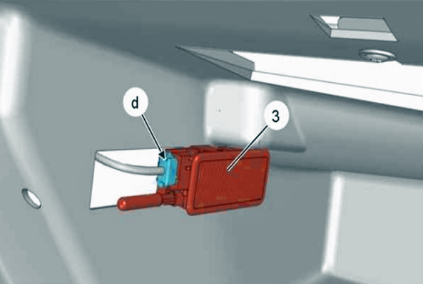

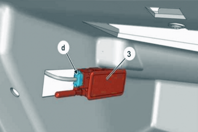

Unclip: The lamp (3) ( as "c") using trim tools.
Detach: The lamp (3).
Disconnect the connector ( as "d").
Remove: The lamp (3).

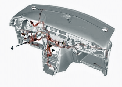

N.B. : Locate the routing of the electrical harness (4).
Unclip - Detach: The electrical harness (4) using trim tools.
Remove: The electrical harness (4).
Remove:
The bolts (6)
The trim (5)
Remove the bolts (7) (The dashboard cross member (8)).
Unclip: The dashboard cross member (8) ( as "e") using trim tools.
Remove: The dashboard cross member (8).
Unclip - Remove: The finishing seal (9) ( as "f") using trim tools.
Re-assembling
CAUTION : Always replace the damaged fixings.
Carry out the re-trim operations in the reverse order to the stripping operations.
Tighten: The bolts (6), (7) to 0.8 da.Nm.
