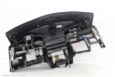

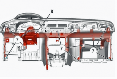

Here an example. Actually this metallic structure is somehow part of the dash, the steering column is screwed on it and the dashboard itself is screwed from the inside on it.
Yesterday when I bought the heater module the dash was removed without the reinforcement and broken.
- x 6955

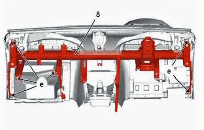

Re: Citroen DS3 A/C Evaporator leak
Ok, I'll put something up now - that's the dashboard crossmember.... give me a few minutes.
- x 6955

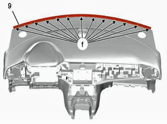

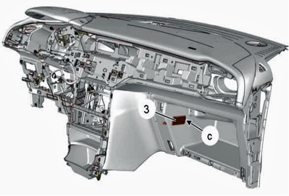

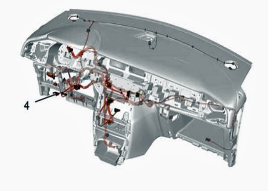

Ok, here is the procedure I think you need:
Re-assembling
CAUTION : Always replace the damaged fixings.
Carry out the re-trim operations in the reverse order to the stripping operations.
Tighten: The bolts (6), (7) to 0.8 da.Nm.
Reconnect the battery.
Check the operation of the equipment.
| Unclip: The air duct (2) ( as "b") using trim tools. Remove: The air duct (2). Unclip: The air duct (1) ( as "a") using trim tools. Remove: The air duct (1). | Unclip: The lamp (3) ( as "c") using trim tools. Detach: The lamp (3). |
| Disconnect the connector ( as "d"). Remove: The lamp (3). | N.B. : Locate the routing of the electrical harness (4). Unclip - Detach: The electrical harness (4) using trim tools. Remove: The electrical harness (4). |
| Remove: The bolts (6) The trim (5) | Remove the bolts (7) (The dashboard cross member (8)). |
| Unclip: The dashboard cross member (8) ( as "e") using trim tools. Remove: The dashboard cross member (8). | Unclip - Remove: The finishing seal (9) ( as "f") using trim tools. |

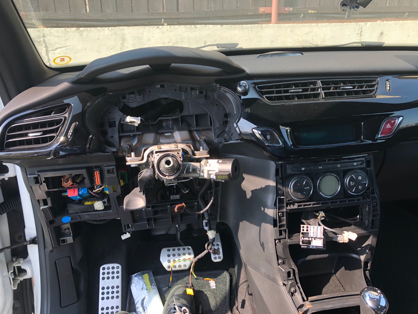

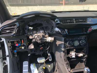

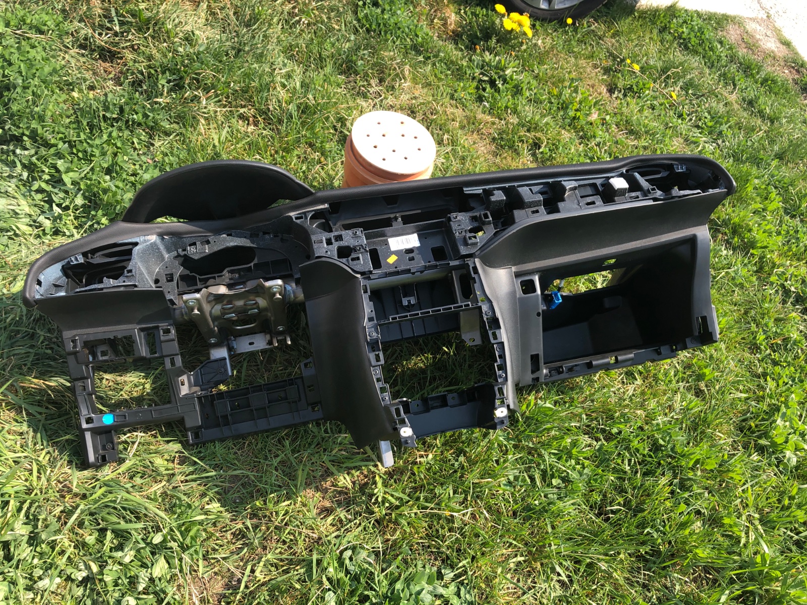

Hello guys! Happy Easter everyone!
Coming up with some news. After 8 hours of work and a few days previously of reading the documentation from Marc, finally I managed to replace the heater matrix on my wife’s DS3. Hard work and requires a lot of attention, especially during the harness unmount and remount, but also on the steering wheel column, being a safety component.
Today I have also been to the garage and refilled the R134a and seems to work quite well. I will need a few more days to analyze it.
My advice, always read three times before unmount something in your car. But if you feel ready, just do it!
Thank you very much Marc for your advices and the documentation, was really helpful each time I got stuck on a step.
Some pictures attached below.
