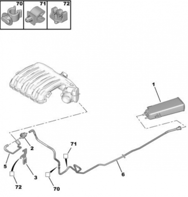

back again. Any idea on a supplier outside dealers for these?

That's not a PSA part code - but if you want the correct part numbers, I'll need to look this data up which is chargeable to the Forum - but if you make a min. £10 donation, this will cover you for up to 2 years for any future parts requests - details and links in the table below: Then just pop your VIN up and I'll be able to sort it.

They call it a Vapor Absorber and is item (1). The PSA part number is: 150771. If you Google on 'Citroen 150771', that should bring some alternatives up for you.
The electrovalve (which I would check first) is item (2) and the part for that is: 16287G.

Many thanks. I cleaned the connections and looked over all pipes to the electrovalve. All seem in good nick. Car has FSH and only 62K miles. so under bonnet is very clean.

Just a quick check - are those two part numbers supposed to be different ?GiveMeABreak wrote: 30 Mar 2020, 13:35
They call it a Vapor Absorber and is item (1). The PSA part number is: 150771. If you Google on 'Citroen 170771', that should bring some alternatives up for you.
Admin Edit - corrected my original Post now.

Think its meant to be the 150771bobins wrote: 30 Mar 2020, 18:49Just a quick check - are those two part numbers supposed to be different ?GiveMeABreak wrote: 30 Mar 2020, 13:35
https://peugeotcitroendsparts.com/produ ... 50771.html
No harm done as I went with the electrovalve as a first try.

Looks like it wasn't the 16287G Electrovalve
