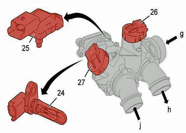

3) You have a Butterfly Double Air Metering Air Doser on this engine, which has 3 functions:
So this will help you identify the relevant parts to check the electrical connections.

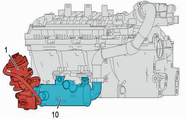

As for the EGR: the fault code P1471 specifically mentions that one of the pins on the electrical connector is open circuit or too hot:
Here are the pins on the EGR connector plug and the EGR location:
(1) is your EGR at the back of the engine and (10) is the EGR Heat Exchanger)
If you suspect it is not regenerating - then try not to drive the vehicle unless essential - as once the filter gets to anything over 70 - 75% full, then regeneration becomes more difficult to impossible and the vehicle will be going into backup mode to limit power.
- Exhaust Gas Recycling (EGR)
- Help in particle filter regeneration
- Stopping the engine
Reference | Designation |
g | Turbocharged air (hot air) |
h | Output: Turbocharged air to the air/air heat exchanger |
j | Input: Turbocharged air cooled by the air/air heat exchanger |
(24) | Inlet air temperature sensor |
(25) | Inlet air pressure sensor |
(26) | Inlet air heater throttle (hot air meter) |
(27) | "EGR" throttle (cold air meter) |
Channel of the electric EGR electrovalve (1297) | signal | Terminal to the engine ECU (1320): Connector | Terminal to the engine ECU (1320): -way |
1 | EGR electrovalve valve position copy sensor supply (5 volts) | 48-way brown | A4 |
2 | Actuator (electric motor) (earth) | 48-way brown | D2 |
3 | Actuator (electric motor) Open cycle ratio (OCR) (*) | 48-way brown | C2 |
4 | EGR electrovalve valve position copy sensor signal | Grey 32-way | D4 |
5 | EGR electrovalve valve position copy sensor earth | Grey 32-way | D3 |
6 | Unused | - | - |
