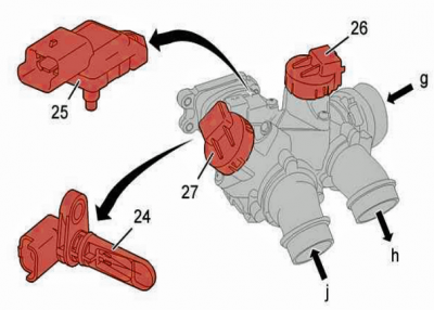

3) You have a Butterfly Double Air Metering Air Doser on this engine, which has 3 functions:
  • Exhaust Gas Recycling (EGR)
  • Help in particle filter regeneration
  • Stopping the engine
ReferenceDesignation
gTurbocharged air (hot air)
hOutput: Turbocharged air to the air/air heat exchanger
jInput: Turbocharged air cooled by the air/air heat exchanger
(24)Inlet air temperature sensor
(25)Inlet air pressure sensor
(26)Inlet air heater throttle (hot air meter)
(27)"EGR" throttle (cold air meter)
So this will help you identify the relevant parts to check the electrical connections.

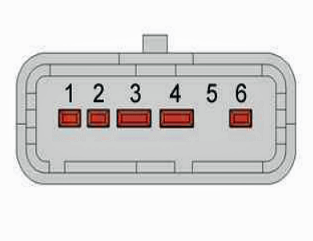

As for the EGR: the fault code P1471 specifically mentions that one of the pins on the electrical connector is open circuit or too hot:
Here are the pins on the EGR connector plug and the EGR location:
Channel of the electric EGR electrovalve (1297)signalTerminal to the engine ECU (1320): ConnectorTerminal to the engine ECU (1320): -way
1EGR electrovalve valve position copy sensor supply (5 volts)48-way brownA4
2Actuator (electric motor) (earth)48-way brownD2
3Actuator (electric motor) Open cycle ratio (OCR) (*)48-way brownC2
4EGR electrovalve valve position copy sensor signalGrey 32-wayD4
5EGR electrovalve valve position copy sensor earthGrey 32-wayD3

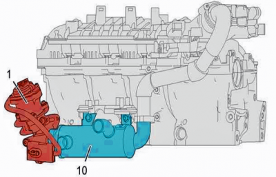

(1) is your EGR at the back of the engine and (10) is the EGR Heat Exchanger)
