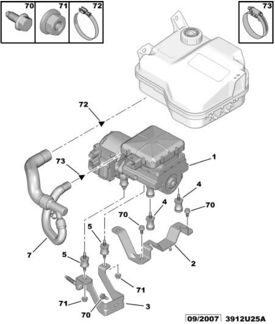

Ok, so the VIN pre-configured part that would of been of been 5277K2, but these are not longer available new. The part number for the one to be configured is 5277K1.
So this is for the complete hydraulic BHI including pump, item (1):
So I've included both part numbers so you can at least get the correct part and then configure it as needed Gino.

Hi Gino - There was a typo on the '5' - have corrected it now.
No that pump is not suitable at all - that one is for a MK II C5 - completely different
