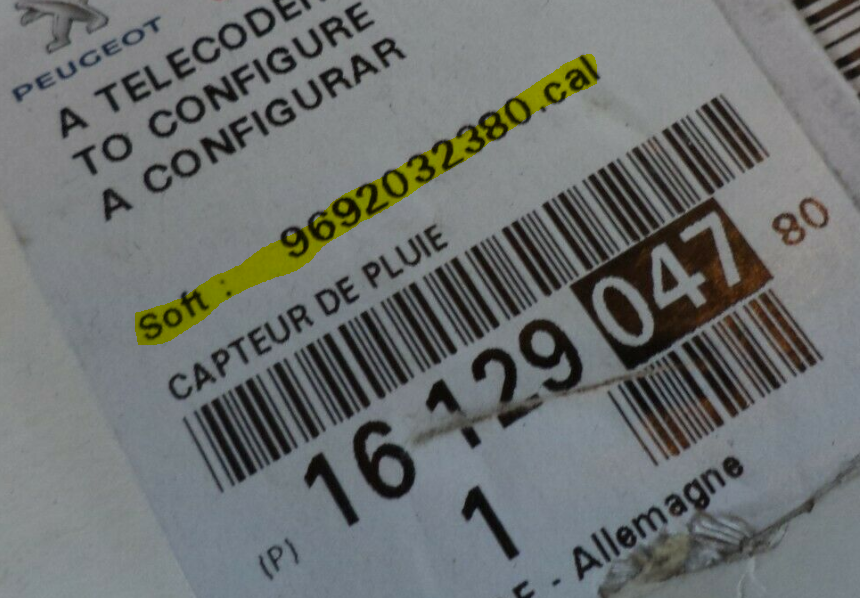

Well done. The sensor usually will be configured with a specific software version from new as you can see here where I have highlighted it in yellow:
The BSI usually needs top be configured if it has been replaced or at least checked to make sure it is recognised correctly. These may be calibrated differently for the different vehicles.
