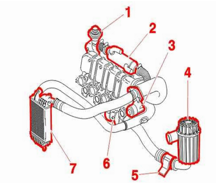

It's a bit early, so data is minimal, but this is the air supply and I think you may be referring to the Air Doser:
Reference | Designation | make |
(1) | EGR valve | PURFLUX |
(2) | Water/recirculated gas exchanger | VALEO |
(3) | Air regulating flap | MAGNETTI MARELLI 48W7 |
(4) | Air cleaner | - |
(5) | Air flow meter | SIEMENS |
(6) | turbocharger | KKK 03 |
(7) | Air/air intercooler | VALEO |

yes that thing.. what is its job in life? I was surprised to see it basically always open at idle, but maybe it shuts and blocks the air inlet for pollution control under certain circumstances ?

a few mins of researching and I get this snippet below.. either way, the doser is not relevant to anything much - I was on some red herring there . as for why mine is open at shut off and idle, no idea.. no care bigger fish to fry in the world.
'I believe at idle speed they close, say, by half forcing greater egr recirc and then they slam-shut when you switch off to choke the engine of air so that it doesn't stop with that old Diesel 'shudder' due to high compression. Diesels don't have a throttle butterfly to vary the air inlet volume rather it is just a big hole where each intake stroke takes in the same amount of air regardless of the throttle position - as such they do shut-down with a bit of a shudder.'
