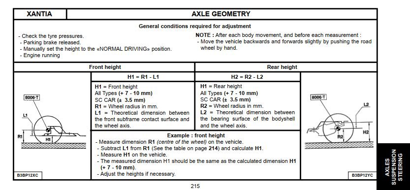

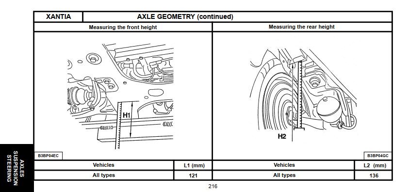

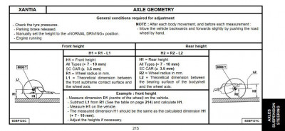

Ride height info here, if you need it...
? click to enlarge The full booklet is here - click on Xantia S2 2001 to download the complete Citroen pdf booklet:
viewtopic.php?p=590278#p590278
You could probably get away with lowering by 1cm at the front, if needed, but I wouldn't recommend any more.
