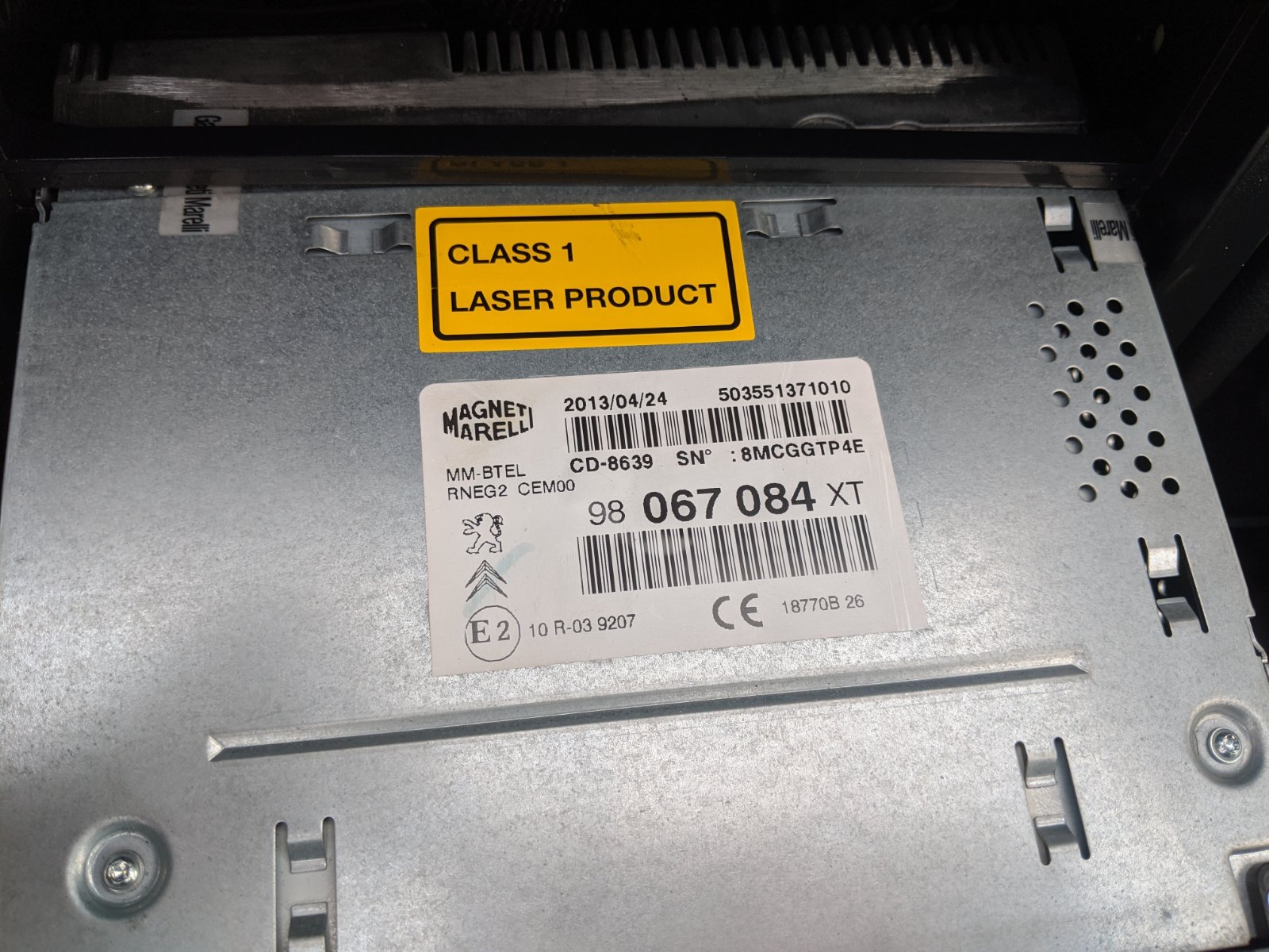

For cd player from Peugeot. I think it's RT6. I also install the diagbox on my laptop and I already have the interface which I already use with my old 307 with PP2000 few years ago.
I also attach the sticker from the top of my player.
I don't know what version was installed and what year map installed.
Guys please help me to restore my cd player and please guide me.
Thanks
Shah

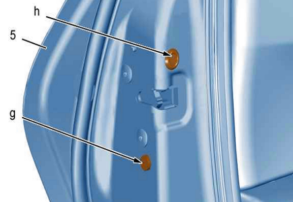

You should be able to lock the vehicle using the key once you have the battery removed. The passenger door should have a lock tht you can use the key on to lock. As for the rear doors, in the picture below, there is a little tab shown at 'g'. You can insert the key in here and turn it to lock the rear doors manually.

So assuming you've got a fully charged battery, do you know what the existing firmware version is? I think it would be better to try and insert the current firmware source first for the existing version you already have installed on the RT6, rather than compound the problem by introducing a new firmware. A newer firmware, especially the latest 2.8* version already brings problems as it is a major update and will also reset the ECU parameters to default values. You really don't want to have to deal with those issues as well as the underlying problems you have.
I suspect that the internal SD card may be damaged or the files on it have become damaged, causing the boor problems - so you can either try and boot the unit from your existing firmware version first and see if that can resolve the file problem. If not, then there is the replacing of the internal SD card procedure described in this topic here (but you will need to find your your original firmware version first).
