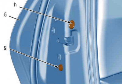

You should be able to lock the vehicle using the key once you have the battery removed. The passenger door should have a lock tht you can use the key on to lock. As for the rear doors, in the picture below, there is a little tab shown at 'g'. You can insert the key in here and turn it to lock the rear doors manually.
Once you have refitted the battery and followed the reconnection part, allow at least 5 minutes for the RT6 to restart itself. Then let us know what is and isn't working.
