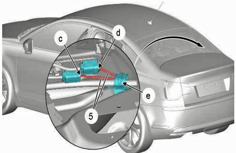

Disconnect the connectors (At "c" and "d").

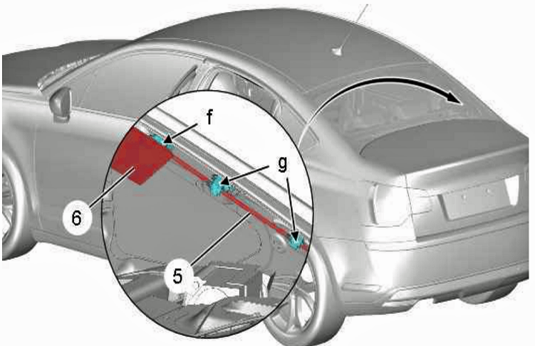

Release the harness (5) (Radio aerial) ( as "e").
CAUTION: Always replace the headlining if
there is any damage or marking.
Release the harness (5) (Radio aerial ( as "g").
Move aside the headlining (6).
Release the harness (5) (Radio aerial) ( as "f").

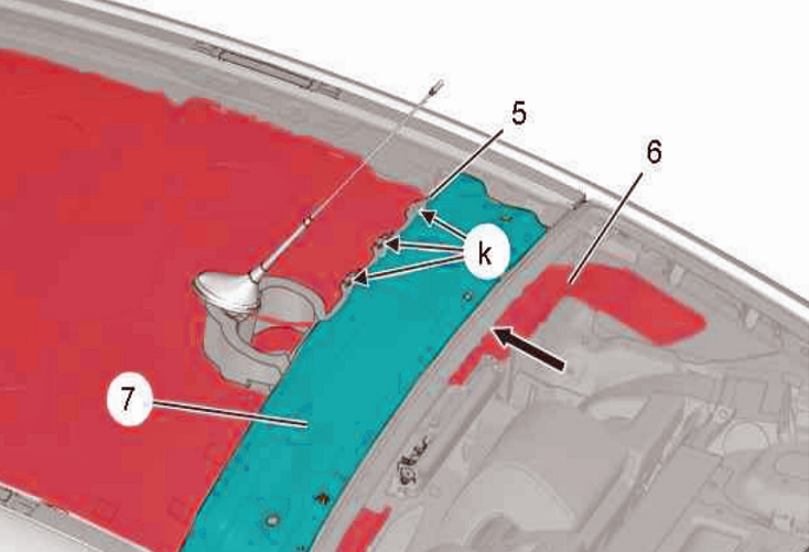

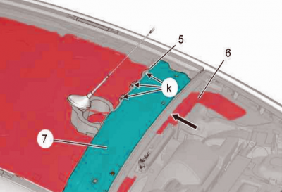

N.B.: Gain access between the headlining (6)
and the roof crossmember (7) (In the direction of the arrow ).
Unclip: The mountings ( as "k") using trim tools.
Release the harness (5) (Radio aerial).

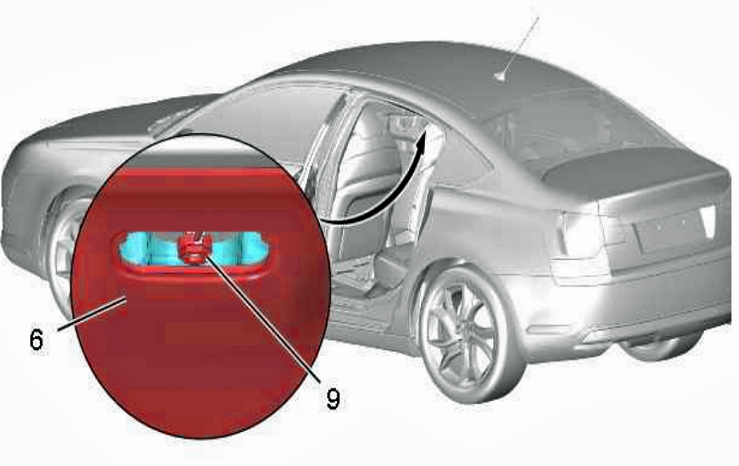

N.B.: Gain access via the rear courtesy light lamp.
Cut: The soundproofing (8) ( as "l").
Remove the nut (9).
Detach and remove: The audio equipment aerial (10)
and the audio equipment aerial harness (5),

Looks like I can get to that nut through the rear lamp but I have to cut that soundproofing foam.
Thanks a lot for the procedure , It's really helping me.
